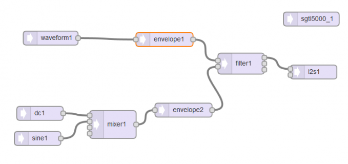

Here is a simple sketch that does audio-rate modulation of the corner frequency of a SVF in low-pass mode. The same note is played over and over, but with increasing (doubling) lfo frequency. Lower frequencies give obvious LFO-type warbling. Higher frequencies produce non-harmonic buzzy, chirpy secondary tones. The initial delay feature on the envelope generator is used to hold off the modulation on the mod envelope, until the sustain phase of the note's envelope is mostly done.
// frequency modulated SVF corner frequency
AudioSynthWaveformSine   sine1;          //xy=134,414
AudioSynthWaveformDc     dc1;            //xy=139,360
AudioSynthWaveform       waveform1;      //xy=162,198
AudioMixer4              mixer1;         //xy=296,384
AudioEffectEnvelope      envelope1;      //xy=366,199
AudioEffectEnvelope      envelope2;      //xy=448,353
AudioFilterStateVariable filter1;        //xy=572,253
AudioOutputI2S           i2s1;           //xy=798,236
AudioConnection          patchCord1(sine1, 0, mixer1, 1);
AudioConnection          patchCord2(dc1, 0, mixer1, 0);
AudioConnection          patchCord3(waveform1, envelope1);
AudioConnection          patchCord4(mixer1, envelope2);
AudioConnection          patchCord5(envelope1, 0, filter1, 0);
AudioConnection          patchCord6(envelope2, 0, filter1, 1);
AudioConnection          patchCord7(filter1, 0, i2s1, 0);
AudioControlSGTL5000     sgtl5000_1;     //xy=828,158
float LFOfreq = 1.0;
  AudioMemory(12);
  sine1.frequency(LFOfreq); // lfo
  sine1.amplitude(0.4);
  dc1.amplitude(0.3);
  // this is the modulation envelope
  envelope2.delay(30);
  envelope2.attack(60);
  envelope2.hold(20);
  envelope2.decay(300);
  envelope2.sustain(0.3);
  envelope2.release(100);
  // now the envelope for the note
  envelope1.attack(15);
  envelope1.decay(45);
  envelope1.sustain(0.7);
  envelope1.release(250);
  // the actual waveform, saw for lots of harmonics so the effect of the LPF is clear
  // amplitude 0.5 to allow for positive gain of filter near resonance
  waveform1.begin(0.5, 440, TONE_TYPE_SAWTOOTH);
  filter1.resonance(3);
  filter1.frequency(440);
  filter1.octaveControl(1);
  // configure output device
  sgtl5000_1.enable();
  sgtl5000_1.volume(0.5);
  // sgtl5000_1.unmuteLineout();
  for (int i = 1; i < 20000; i *=2) {
    LFOfreq = i;
    envelope1.noteOn();
    envelope2.noteOn();
    delay (1500);
    envelope1.noteOff();
    envelope2.noteOff();
    delay (500);
Nice work! I'm listening to it now. Hearing slightly different wobbly sounds on the tones. Good to know the filter is doing something. ;)
I'd love to include a couple examples like this with the library. Is there any chance this could be expanded to sequence multiple sounds with musically pleasing rhythm?
It shows that audio rate modulation works, at least. The various levels and DAHDSR values are probably not optimal. I did get some (nasty, hard, not musically useful) clippig distortion if the levels were set too high.
Yes, some sort of evolving looping 8-step sequencer style demo perhaps.
