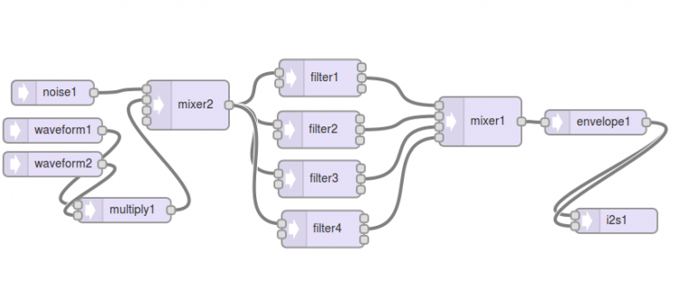

/* Formant values for vowels taken from CSound manual appendix:
http://csound.github.io/docs/manual/MiscFormants.html
AudioSynthNoisePink noise1; //xy=65,218
AudioSynthWaveform waveform1; //xy=65,264
AudioSynthWaveform waveform2; //xy=65,305
AudioEffectMultiply multiply1; //xy=152,361
AudioMixer4 mixer2; //xy=229,233
AudioFilterStateVariable filter2; //xy=388,263
AudioFilterStateVariable filter3; //xy=389,323
AudioFilterStateVariable filter1; //xy=390,200
AudioFilterStateVariable filter4; //xy=393,384
AudioMixer4 mixer1; //xy=584,253
AudioEffectEnvelope envelope1; //xy=724,254
AudioOutputI2S i2s1; //xy=749,374
AudioConnection patchCord1(noise1, 0, mixer2, 0);
AudioConnection patchCord2(waveform1, 0, multiply1, 0);
AudioConnection patchCord3(waveform2, 0, multiply1, 1);
AudioConnection patchCord4(multiply1, 0, mixer2, 1);
AudioConnection patchCord5(mixer2, 0, filter1, 0);
AudioConnection patchCord6(mixer2, 0, filter2, 0);
AudioConnection patchCord7(mixer2, 0, filter3, 0);
AudioConnection patchCord8(mixer2, 0, filter4, 0);
AudioConnection patchCord9(filter1, 1, mixer1, 0);
AudioConnection patchCord10(filter2, 1, mixer1, 1);
AudioConnection patchCord11(filter3, 1, mixer1, 2);
AudioConnection patchCord12(filter4, 1, mixer1, 3);
AudioConnection patchCord13(mixer1, envelope1);
AudioConnection patchCord14(envelope1, 0, i2s1, 0);
AudioConnection patchCord15(envelope1, 0, i2s1, 1);
