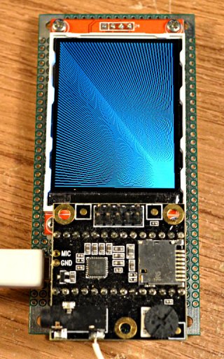

Here's a photo of it working, at least graphicstest, with the audio board and those alternate connections. Hopefully this helps?

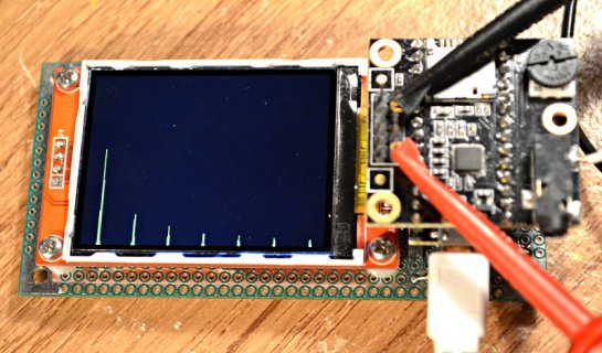

I just wrote a quick TFT spectrum display, showing the first 320 bins of the FFT (approx DC to 13.76 kHz).
Here it is, with my function generator sending a 1 kHz square wave:
(click for full size)
Here's the complete source code, using the Audio and ILI9341_t3 libraries.
