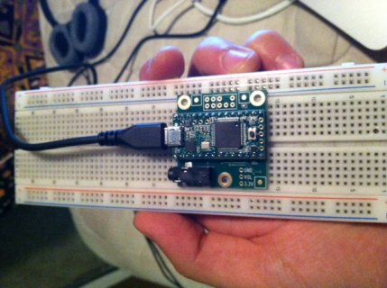

Has anyone had the teesny audio board short itself?
my teensy shut itself off after opening File>Examples>Audio>Analysis>DialTone_Serial --- and also shut down my computer!
Any ideas?
Thanks!
Zach
--further details--
I have my teensy 3.1 with soldered heads on both sides (I have checked for shorted pins, there are none) plugged into the teensy audio board (i know it is facing the correct direction)
I plugged it into an empty breadboard(with the two sides/columns of pins separated by the breadboards divider of course...) and connected power. Everything was fine. My headphones were plugged in if that is relevant (they definitely work/aren't shorted). I then uploaded the Arduino Examples sketch DialTone_Serial - it uploaded successfully and then teesnyduino prompted me to reset the teensy (press the black button). I did so and the power LED of the teensy turned off, my computer screen made a flash, and then everything shut off.
I've turned my laptop back on - it still works. But when i plug the teensy back in, no red power LED comes on.
Has this happened to anyone? Does this seem as though the board shorted itself? I checked the 3 and 5v pins with voltmeter connectivity and neither are shorted to ground. it just wont turn on.
I seem to have checked every possible hardware fault and I'm certain it isn't anything I am doing - unless my breadboard has a wire stuck inside connecting the parallel rows of power and ground? (kinda doubt it)
Unfortunately, this was the first sketch I uploaded to the teesny with the audio board attached, and so the problem could either be with the board itself or with that patch specifically.
* and the weirdest part of it all is that when i take it off the breadboard and put it back on (along anywhere up or down the board) the on board LED flashes orange for a brief moment, and will occasionally stay on for a few seconds. And when i remove the teesny from the audio board and do it alone, it doesnt f
Any ideas?
