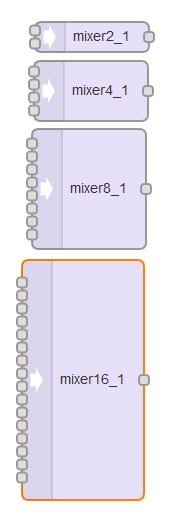

Committed mixer8 and mixer16 to github. Can anyone see a good reason for a Mixer2 and a Mixer32? Overkill? Or enabling perfectly efficient system design?

A mixer2 (or mixer1) would be a more neat way to set the gain of a single signal I'd say. I found the mixer4 a bit of an overkill in the Mid/Side example, but it's an easy way to control gain.

Agreed, overkill results in wasted RAM, even if not CPU time.
The solution here would be a mixer2 (which I will add), but I cant do a mixer1 because its not actually a mixer.
What we're talking about here is a single channel gain object, preferably with an additional input port to connect sine waves or similar for modulation of gain (a VCA). It could be connected inline between the sound source and the mixer (or sound output)

For now, i think a mixer2, and an inline gain object with a VCA style input would be ideal. It could be used in place of a mixer in many situations, particularly synths.

A gain component with VCA is already present I think (the multiply effect). However, it doesn't have a static multiplier (e.g. setGain(float))... To me it seemed adding the SynthDC object purely for that constant VCA signal is overkill, and a simple constant gain component would be more efficient.
The mixer2 would come close enough to that constant situation I guess.

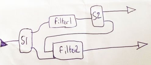

I had a dream...
How hard would it be to implement this? :)
It would take us a great leap closer to dynamic patch cabling

I think you can do this already - the link from object to object is a pointer and there can be multiple pointers,
I have been thinking of writing a selector object that works the other way - select one of n inputs to a single output. I need this for my software defined radio project. For the radio to transmit the audio signal path has to be reconfigured. The nice thing about a selector is its computationally very cheap since you just fiddle with some pointers.

Re splitter you mean a dynamically assigned splitter than can be changed on the fly I assume. But all the audio connections would need to be allocated anyway, so it would be a patch to give a little more functionality, where what we really need is audio audioconnection.create and audioconnection.destroy
Would be a very easy addition though.

Yes a splitter (ideally with volume control or simple on/off of each output) would enable things like in this horrible drawing, using splitters S1 and S2 to set two filters to be either in parallel or series on the fly:
I forgot the mixer for the two signals going into filter2 but you get the idea. This would also open new doors for modulation patching, fx bypassing etc :)

Having established that you mean switchable outputs, not just a simple fanout, that does seem like a useful object (although the name should reflect that).
The common configurations are individually switchable outputs, and a serial mode (one output on, all the others off), typically used with a clock (clock input advances to the next output).
That might be easier as two objects:
one called toggles (or toggles2, toggles4, toggles8, etc) with individually selectable, individual outputs using methods like enable(n) and disable(n)
and another called sequence (or sequence8, sequence16 etc) with methods like setOutput(n), advance, advance(x). x would be a signed value so advance(-1) is possible as well as advance(3) and so on. advance with no parameters is just syntactic sugar for the most common option, advance(1).
