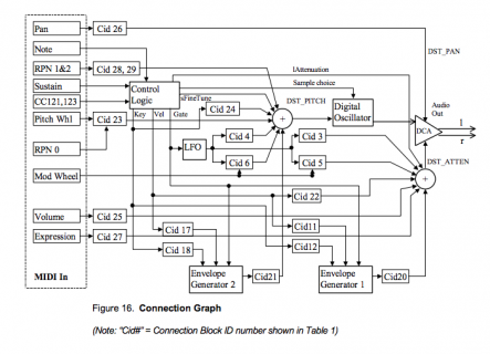

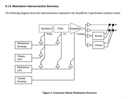

My long term plan involves SoundFont. That plan may change, but so far, I've looked at a LOT of audio stuff and the SoundFont format seems to have by far the most good quality wavetable sound libraries published. At least a few very good, completely free SoundFont libraries exist covering all the general MIDI sounds. If there are other formats used to publish wavetable synthesis sounds, I'm certainly willing to consider them. However, I'm not willing to consider legacy formats, so if any reading this has a lot of nostalgia for Amiga, please know I'm not considering MOD format (but I wouldn't be opposed to accepting a contribution to play MOD...)
Of course, you're not going to load a SoundFile file directly into Teensy's flash memory, or even the SPI Flash chip. Some sort of conversion utility will load the SoundFile file and let you choose which voice you wish to use. It'll need to have some GUI controls to let you trade-off size vs quality in a variety of ways. Then it'll output raw data, optimized for the library, which you can copy into your sketch, or (someday) put onto the SPI Flash.
SoundFont is complex, but at least it's an open and (fairly) well documented file format. I'll attach the spec.
Chapter 9 is probably the most interesting part to read first. The diagram on page 48 shows most of the components needed. The "Oscillator" part actually plays an attack sample, followed by looping a waveform sample. Both are resampled to the desired note.
Hey Paul,
I am curious if you considered the MIDI-DLS standard.
The specification is here:
http://www.midi.org/techspecs/dls/dls1v11b.pdf
And a high level overview of the two formats in one article:
http://www.emusician.com/gear/1332/downloadable-sounds/31654
Both standards are based on a RIFF file format, and seem to be very similar.
It seems that if your objective is to have many freely available sound packages for whatever format Teensy supports, DLS might be a viable alternative, as there are a few software packages out there which can convert between the two, with one big BUT that comes from the previous article:
DLS sound libraries are more difficult to find, but programs such as Awave and Audio Compositor allow you to open a SoundFont and save it as a DLS Level 1 or DLS Level 2 file. Be aware, however, that when you convert from a SoundFont to a DLS Level 1 file, you lose any filtering or layering programmed into the SoundFont patch.
That being said, the fact that DLS is part of the Open MIDI standard makes me 'feel' a bit better, instead of using something that is created by Creative Labs, but it seems that neither have changed all too much since their inception in the 90s.
The reason the MIDI DLS standard caught my eye was the connection graph. I am still reading through the spec to see exactly how they differ aside from DLS lacking Chrous and Reverb built in (I am not sure if they are the same, but the soundfont graphic being more abstracted), but here they are side by side:
MIDI DLS:
SoundFont:

The DLS and SF2 formats are designed to be sound banks for complete sounds that are ready to go, to be implemented as instruments in and of themselves.
As part of a full DSP library, I am not certain they make sense since they will constrict the user into using the filters, panning, envelopes, LFO, CC modulation and pitch bend as specified by the soundfont or DLS file.
Since these are all part of a full DSP library, it seems to me that the wavetable synthesis should be separate from all other components of the synthesis chain, especially in a CPU constrained environment.
Both SF2 and DLS have only low pass filters in their specifications, and each soundfont will include pre-sets for these filters inbuilt. In order to use a high pass, or bandpass, or a different type of filter, you will have to be able to access the digital waveform alone, and patch it out separately, and you might end up having to use two filters in the same code, one which is not even used at all. If that is the case, then all either of these formats are going to get you are pre-sets that make it easy to make sounds.
If instead the wavetable synthesis portion only included the digital oscillator, that would allow users to patch that oscillator into any processing they wish. If readily available sample sets are the goal, then tools or documentation needs to be created to take a WAV sample and convert it into a wavetable sample (with separate start and loop segments). That would result in far more available sample sets in the future, instead of locking us into what is available with the seriously aging SF2 and DLS communities, which don't seem to have anything new that has been created since after 2005.
I would love to work on a library of pre-sets that would allow people to have code ready to go that produces awesome sounds. I was trying to work on this, and posted in another thread when I had issues including the Audio library in another library of my own creation. I found though, through one of your posts earlier in this thread that that would not be possible.
