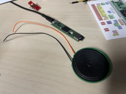

Hi, I'm new to Teensy and this is my first project. I got a Teensy 4.1 and one of the thing I wanted to make is it to play music through a speaker. After spending hours looking online how I could achieve my objective I'm starting to lose hope. I do not know if it is achievable with only the pieces I'm using (Teensy 4.1, SD card, a very simple speaker). Ergo I am asking for help.
On Arduino, I have used the File>Examples>Audio>WavFilePlayer example as my main template. I removed some code that I think did not matter for what I am doing.

My most urgent questions are: Where should I connect the speaker on my Teensy 4.1? How do I call the music in the SD to the speaker and what important commands am I missing?
Thank you
Unfortunately you won't be able to do what you want with just what you've bought.
The 3.1, 3.2, 3.5, and 3.6 Teensies (for which the example was written) have 1 pin (Teensy 3.1 and 3.2) or two pins (Teensy 3.5 or 3.6) that are analog DACs. An Analog DAC is a pin that when you do an AnalogWrite to the pin, it modifies the voltage on the pin to be between 0 and the reference voltage (typically 3.3v). The sound produced by a DAC is decent, but other sound systems (including the audio shield on the Teensy) produce much better sound. Unfortunately the microprocessor used in the Teensy 4.0/4.1/MicroMod no longer provides a DAC.
For most other pins, if you do AnalogWrite to the pin, it uses what is typically called PWM (pulse width modulation) that turns the pin on/off very fast, so that the average voltage will be what is specified (note some pins don't support PWM). This PWM is useful for making lights dim. It can be used for playing sounds, though it may not be as good as a DAC might be.
You can then connect this DAC pin and ground to an amplifier, which then connects to a speaker. I don't know what pin AudioOutputAnalog audioOutput uses on the Teensy 4.0, but if it there is a way to set the pin to a pin that does PWM, you can use the new Audio Output function (AudioOutputPWM) that uses a PWM pin for output. You would need to use Teensydunio 1.57 (the current release) to use this. I haven't tried function myself.
If you aren't connecting up a display that uses SPI (most displays do use SPI), you can use pin 10 and 12 to output sound via MQS (medium quality sound). Unfortunately MQS uses pin 10 and 12, while SPI requires using pin 12 for the MISO function. While I have an example that just uses Tonesweep with MQS, I haven't hooked it up to the SD wav player.
The main option that people do is to use an extra card that offloads the audio processing. There are at least 3 different cards that you can use:
  • The main approach is to use the official Teensy audio adapter. This is a board made to be mounted on top of or under the Teensy (you will need to solder pins and headers for this),
  • PJRC has a much cheaper board that uses a PT8211 chip. Even though I've bought some of these boards, I haven't actually soldered them up to use.
  • The third option is to get an external I2S device that you hook up to the appropriate pins, and hook speaker(s) to the device. There are typically 2 variants. One variant provides stereo, but you will need amplifiers on the speakers. The other device is a mono device, but it provides the amplifier. Here is one I bought: https://smile.amazon.com/gp/product/B07PS653CD/ref=ppx_yo_dt_b_asin_title_o00_s00?ie=UTF8&psc=1
As I mentioned above, that once you produce sound in some fashion, you will need to put an amplifier between the Teensy and the speaker. Otherwise, you likely would only be able to hear a faint echo. You can buy them in various places, but you will need one if you want to continue. Here is one on ebay that looks like it might do the trick (though it looks like you will get 10 parts): https://www.ebay.com/itm/334461295386?hash=item4ddf725b1a.
Another alternative, that may take more work on your part to set up is to make the Teensy into a USB audio device. You build the Teensy as a Serial + MIDO + Audio (or just Audio device) instead of the normal USB serial device. Once you attach the Teensy, you may need to do something on your system to enable using the device (under Linux I needed to set the Teensy as the default input device, and then issue the 'play -d' command). The advantage is that you won't need any extra parts (assuming your computer has speakers that are turned on).
