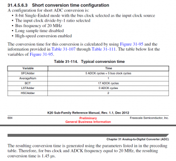

1) Can I record and play sound at 44.1KHz sampling rate using the ADC and DAC available in Teensy? I know that the available memory might be a limitation, but I do not need to store the recorded audio, just some DSP with it and discarded.
