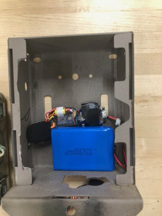

DD4WH
Hi Garth,
Walter has already answered your questions, he was faster than me
One additional thing:
* I do not recommend the use of USB power banks any more
* the #define SLEEP_SHORT with the according ShortSleepDuration works for some types of power banks, but some power banks do not wake up, because the current from the Teensy is still too low
* I purchased an ANKER PowerCore 13000 about a year ago, it works very well and wakes up, BUT then I purchased exactly the same model again a few weeks ago, and it looks exactly the same from the outside, but that does not work at all and is not waking up . . . seems they radically changed the battery management system
So, I now soldered battery holders to all my prototypes (3 x AA batteries = 3.6 to 4.5 Volts depending on your battery type, connected to Vin and GND) and I do not use power banks for recording any more. This has two additional advantages:
* much more reliable
* current draw is drastically reduced, because it seems that a significant proportion of the current drawn was consumed by the power bank alone, and not the Teensy
* AA batteries can be purchased everywhere worldwide, even in remote areas in the tropics and can be taken with you and help a lot if you do not have the means to recharge your power bank
* for longer periods, you could even use C or D battery types to allow for several weeks of unattended recording
I also put this information into the WIKI:
https://github.com/WMXZ-EU/microSou...es,-current-consumption-and-battery-life-time
Frank
