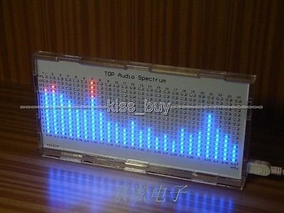

I want to create a wall-sized audio spectrum analyzer. I'll be something much bigger than the picture above, that I'll hang on my wall. I am thinking 60x32 = 1920 LEDs. In order to do this, I need to analyze audio live and drive all these LEDs at the same time. That led me to Teensy controllers. I don't know how fast of a microcontroller I need, but I figured Teensy 3.6 is plenty fast with it's 180Mhz clock rate and floating point arithmetic unit. The audio library provided will help with the audio analyzing.
