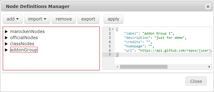

Node definitions manager "manual"
Is opened from the tool "main menu" found in the (top right) side of the save button.
It consist of three parts
1. Left panel:
Tree view of the nodetypes grouped into groups.
The first two are readonly (embedded into the tool)
the 3:rd is autogenerated readonly and contains the "tab"-classes
2. Right panel:
contains either the selected group or node def in json format,
this can be edited and saved for "non readonly" items.
3. Menu Toolbar

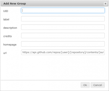

add:
single add new group/node def.
only add new group is having a form to fill in,
the add new node def. is using json to edit the data.
new group dialog:
new node def. type dialog:
import:
from url: downloads the node def. from a internet url
(server need to allow CORS, best is to use Github)
from file: not implemented yet (should work just like the above)
refresh: not implemented yet (should update the current addon from the url given)
remove: removes current selected group/node def. (only for "non readonly" items)
note. using a confirm dialog
export: exports all current groups and node def. to a json file
(can only be imported by uploading it to Github in a html file using the DesignToolNodes.html format above)
this is only intented for debugging but can be used to export node def. when creating own libraries
apply: saves and applying the current edited item ("non readonly" can only be saved)

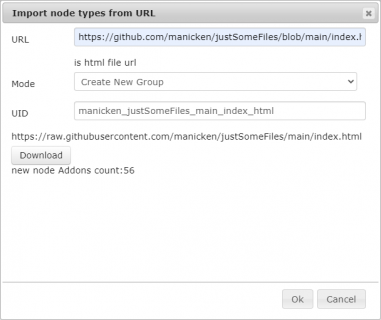

How to use import from URL dialog (and how it works)
the URL:s can be in the following formats:
if it ends with html
and starts with "https://github.com" then the url is changed into the raw file url format,
("https://raw.githubusercontent.com")
else the url is not changed
note. the NodeDefinitions format can either be "classic" format
or the new group based format.
else if it starts with either
"https://github.com" or "https://api.github.com"
and is a url to a folder
then all the .h files in the folder is downloaded and
scanned for the chipaudette //GUI: tags described above.
this is shown in a new form dialog
after the correct supported url is given
it shows what format it's in
and enables the download button
if the old NodeDefinitions html format is used
then both the Mode and UID fields are shown so
that the user can input the UID needed.
When everyting is filled in and the download is completed the OK button is enabled,
which will when pressed, import the downloaded node defs.
