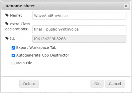

* I have now included a option that is found in the rename class(tab/workspace) dialog.
(it's opened by double clicking the tab)
I have also created a field to add extra class declarations when having inheritance.
There is also a new object called destructor code @ special category
this makes it possible to add additional destructor code

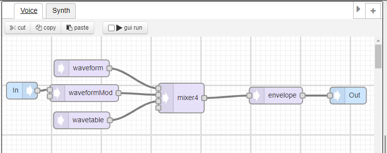

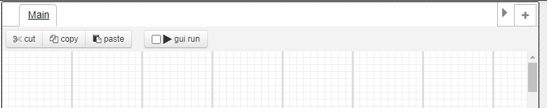

Better to just describe how it's done:
first it starts with an empty project:
to first create the voice class
here you rename it by double click the main-tab
second you can add and second tab by clicking the top right '+' sign
this new tab is renamed the same way
third switch to the Voice class
and edit the design
note. the input and output objects they are found in the special category
the input and output objects are just placeholders do define the inputs/outputs
for the Voice class.
last create the synth class
the new Voice class is found in the "tabs" category
here I'm using the "template mixer" but for designs using only 4 voices the standard mixer can be used
then only connect the voices[4] output to the first mixer input, the tool takes care of the rest.
This is the most basic design of what I can think of.

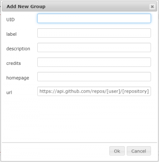

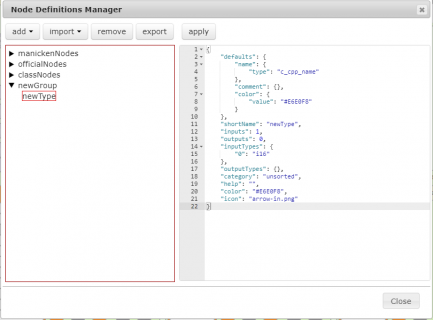

Update for the Node Definitions Manager Manual (i.e. adding new custom AudioObjects to the tool)
open node def. mgr.
click add group
fill in the details
(note there is a popup text for each of the fields describing what it is)
then select the new group (here I choose the UID newGroup in the prev step)
click add new node type
here the TypeName is your custom AudioObject class name
(example AudioMixer4 is the class name for the mixer4 object)
Specially check and change (if needed) the following json variables
shortName, inputs, outputs,
inputTypes and outputTypes should be removed if not used
also note that inputs and outputs have no use if inputTypes and outputTypes are defined
as the inputs and outputs are set from inputTypes and outputTypes if available
if you still want to use the iotypes the syntax for inputTypes and outputTypes
is:
"inputTypes": {
        "x4": "i16"
here it means there are 4 inputs
then you have the new AudioObject to play with
note you can always change the node def. afterwards
just select the type
make the changes and press Apply

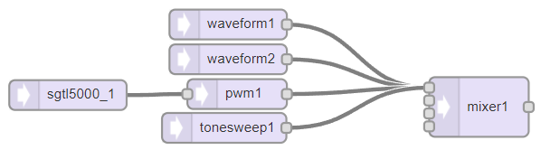

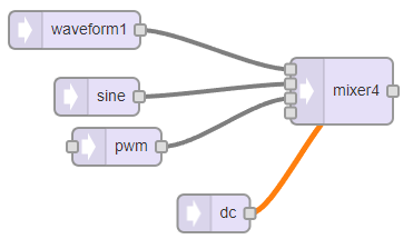

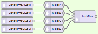

Some updates:
* Fixed my "Flexible" AudioMixer object (just called mixer in the mixer category)
Now it autogenerates mixer code for every mixer variant that you use.
that is included at the top of the generated code in both "flat" simple and class exports,
when exporting as zip two files are generated mixers.cpp and mixers.h
+ supported at simple export
("flat" exports right now generates multiline code but I plan to do some one liner compact code of it)
+ don't generate code for the 4 input variant that already exists in the Audio Lib
* Simple export can now handle arrays (only support standard Library Audio objects)
so the following design can now be exported
here the junctions are only to make the design easier to follow
and the group box is to clarify what belongs to the "voice"
also note that I have used the "Flexible" mixer both in the voice and as the "external" main mixer.
To use the mixer with a array the "autosize" only works if the mixer have one input.
Also note that the maximum allowed inputs of the mixer is 255
so if a "sourcing" array is bigger than that it will truncate at 255.
So if you want to do a 1000 mega drone

* On Node-RED there is a neat feature, but caused some problems on this tool
When a link is drawn from a object output to another object you don't actually have
to drop the link on a port, instead you can just drop it anywhere on the 'target' node
this did make it possible (still on the official tool, so you can try it there)
to connect multiple signals to the first input of any object.
this above also make it possible to drop a 'input' (when a link is drawn from a input)
to objects not having any IO (that means all control objects)
the all above problems are now fixed in my tool
* you can't drop any link to any object not having any IO
* now when a 'output' (when a link is drawn from a output)
link is drawn it can just be dropped to a object and it will automatically add itself to the first free input
This "auto add" feature can be turned off in settings-"Workspace/view"-Nodes-"Auto append dropped links"
if you find it annoying
note. the opposite is not yet possible i.e. adding a 'input'-link automatically to outputs of any node
here is how I drop a new link to a mixer
note. if the second input was free (not connected to)
then the new link would be connected to that instead of the last input
here is a diagram showing how it could look like before
Is the Node Definitions Manager broken at the moment? I don't seem to be able to add a new node type to my group...
This may be academic, as it's a new implementation of AudioEffectDelayExternal I want to test, which requires two parameters on construction: int (storage type), float (max delay length [ms]). And I don't think there's an easy way of specifying those in the GUI, and then passing them to the OSC uploader on export.
are you trying to add it to the h4yn0nnym0u5e "category"?
as that is "hardcoded" and readonly
(and currently used to hold the AudioStereoMixer)
also note that the name
cannot be used
and you need to use a different name
(just saying)
