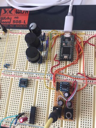

Hey, I am trying to make a project and more precisely an VCO with CV for freq and CV for waveshape for now.
The design is made in the audio tool and the waveshape are fading between them via knob 1, freq via knob 2, etc.
The problem encountered is the lack of stability of the frequency, as you can see in this short video for SQR shape..
Video issue:
[video]https://drive.google.com/open?id=0B3N82IlvifmDTjAxYm43dDB1eFE[/video]
Maybe my code is not well done or maybe something is missing, what do you recommend, should i add something else to my code or do i have to use some tricks To make it more stable? Any suggestions? Thanks!

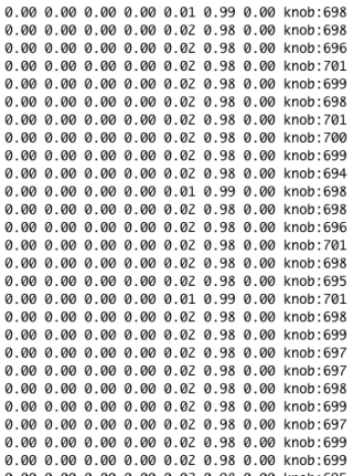

Serial.println(KnobValue);
Serial.print(" ");
Serial.print(knobPartValues[6]);
Serial.print(" ");
Serial.print(knobPartValues[5]);
Serial.print(" ");
Serial.print(knobPartValues[4]);
Serial.print(" ");
Serial.print(knobPartValues[3]);
Serial.print(" ");
Serial.print(knobPartValues[2]);
Serial.print(" ");
Serial.print(knobPartValues[1]);
Serial.print(" ");
Serial.print(knobPartValues[0]);
Serial.print(" knob:");
