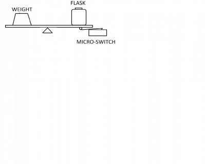

How about something like the Weigh Bridge scheme shown below.
When the flask is full it will come up to balance and close the micro switch.
