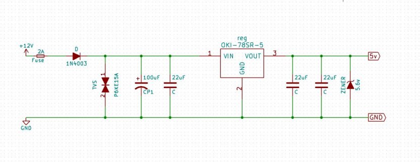

Seeking some opinions on the attached power supply schematic. suitability, functionality etc
input voltage will be around 13.7v with engine running
D1 1N4003 to provide protection against reverse connection
TVS diode is a P6KE15A. datasheet [wrong symbol on schematic]
OKI-78SR-5 dc/dc datasheet regulator to provide 5v to teensy 3.5 or 3.1 and some 5v sensors (mpx4250's or similar, outputs are connected to analog pins through voltage dividers)
the 5.6v zener is to protect against reg failure, will need to be man enough to pop the fuse
will be used in my data logger project. any advice welcome, i am a beginner
