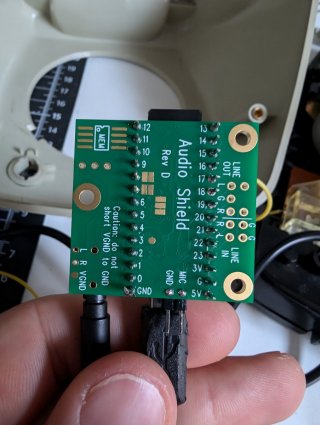

Hello, I am trying to set up a teensy to play some audio on a speaker. I have soldered the teensy board to the audio shield and am using an aux cable connected currently to a set of headphones to play music. When I try to play something across it however, the quality is very choppy and noisy. I thought it would be an easy fix, but currently I am at the point thinking I have tried everything. I could really use some advice.
The things I have tried and found are (all resulting in the same problem):
- Setup a completely different teensy 4.0 + audio shield
- Use different speaker
- Use laptop as power source
- Use psu as power source
- Disconnect all other cables from teensy
- Bypass aux cable by connecting directly to the pads on the shield
- Use synthesizer example sketch
- Use sd wav player example sketch
Listen to the recording of the guitar synthesis here:
I am attaching some images of my setup.

Ok, 5 minutes later i have solved it ;)
When uploading the sketch I used some "tweaks" which enabled "bigger blocks (256 samples)" I was told this would improve something... I dont know what but just assumed it was good. Apparently it resulted in horrible audio.
Maybe this will help somebody in the future.
The "bigger blocks tweak" is mine, and very specifically for the Audio Guestbook sketch. See discussion starting here for details, though note you'll have to read a lot of posts to find a link to the latest version. The bigger blocks were needed to help recording on slower SD cards, but that broke the standard library's playback (as you've discovered), so I also had to supply a copy of the playback code which could cope with the bigger blocks.
If you have what you need all is good. If you run into any more issues, you could give my improved recording / playback code a try - see this thread for the discussion on that...
