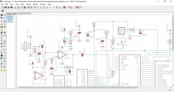

Struggling here with the opamp version board, somehow I seem to have the spurious signal that was described and all of it's harmonics now that I am amplifying with a tl972. ( The one on the right.)
It does not realy make a difference which one of the two MEMS I use.
I did however manage to get rid of most of the display update sounds. Strange enoug most noise was gone after I removed the 100nF decoupling capacitors.
I'm now waiting for the bats to start flying, of Just heared the first.
Sofar I do seem to like the transistor amplifier better.
This opamp still needs some improvements.

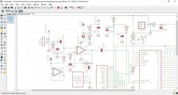

Hi Remis,
I do have an oscilloscope. A cheap one but I should be able to see some signals I guess. Although these seem quite tiny and my oscilloscope might not be the best choice.
I have no electronics education so please correct me if I a doing anything stupid here.
In most amplifiers i see a large value resistor attached to 1/2V If I do that I also see a strong signal near 23Khz. Would it not be better to use a value that just about matches the output impedance of the microphone element here? (250 ohms single ended output +)
Maybe I should better just be concentrating on building the differential amp.
Kind regards,
Edwin
If VCC/2 is perfect : low impedance point DC value but no AC signal . Two solutions:
_reduce R6, R5 to small impedance, comparred to R2 and increas C6. Ok but this solution will increase the DC supply current into R5, R6 : thus on 3V3. : bad idea
_simply connect R2 to IC1B ouput : voltage = VCC/D and Dc current = AOP power suppply this is the best: voltage follower designed for this
R2 is the impedance seen by Mic ouput. In our use case it is not mandatory to use the same impedance : change to 10K :
Check that without mic , you don"t have any spurious on VVC/2 : you can add ceramique capacitor // 10µF chimique capacitor on IC1B pin7 ; chech TFT spectrum
lowering R4 to about 4.7k : start with lower gain
for test purpose , increase C3 to few µF : spurious frequency could chnage if it is comming from AOP oscillation. Don"t change if comminf from Mic

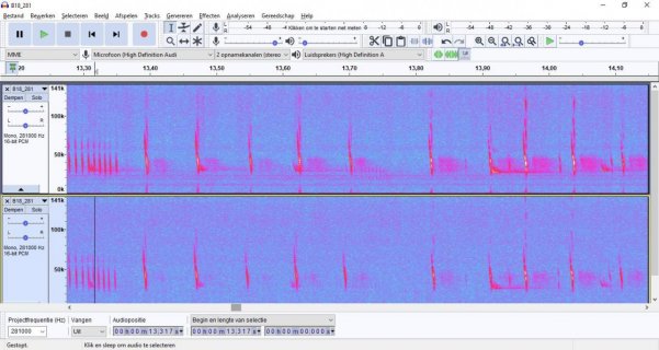

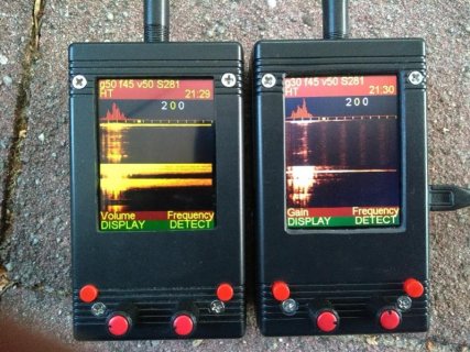

So here we are again, using the opamp amplifier, and ICS microphone in single output mode.
I did change the biasing resistor to match the impedance of the microphone, this helped to get rid of the unwanted signal on about 23Khz and its harmonics.
I also lowered the amplification a little because there was a bit too much noise from the display update data.
The images here show the old transistor amplifier at the top and a new board with opamp at the bottom. (the old and new device recording next to each other.
The bottom spectrogram images seem to be less signal and less noise but also a lot less harmonics. The funny thing is it does seem to pick up the signals sooner than the louder looking transitor amplifier.
The operational amplifier is made to not amplify low frequency sounds, amplify 20Khz signals only around 5db but around 100Khz it should amplify by about 15dB
first and last recording were with gain at 50, the middle recording was a little closer to the bats, I recorded at a gain of 30.
