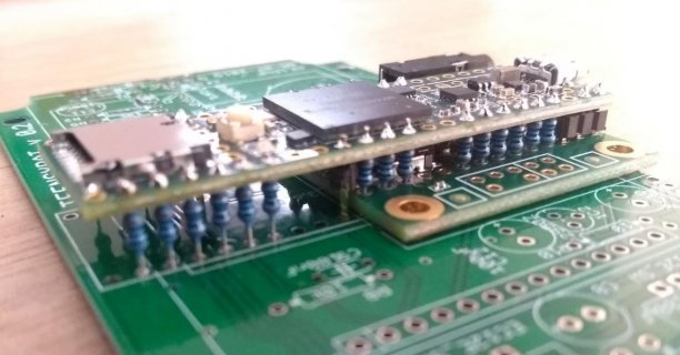

These are my new headers....
I used small 1/8 watt 100 ohm resistors on each and every data line, to the display, but also the audioboard, encoders and buttons.
All GND, 5V, 3v3 lines are connected with standard header pins.
Maybe just the display datalines would have been enough but I just wondered if everyting would still work fine with 100 ohm in every dataline.
The display update noise could also be seen on the waterfall display and was best heared in spectrum mode.
Since the display is not updated during recording there was not a big impact on the recording but I think also that looks better.

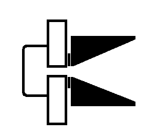

I have been out to capture some bat calls and try different cones on my microphone.
As far as I can tell there is much less 23KHz signal to be found when the opamp is used in stead of the transistior amplifier. The long cone that helped to suppress the big signals does not seem to be needed on the opamp.
To create a seal between the microphone and housing I used a nylon bolt with a holle drilled tru and a thin piece of rubber (ring punched out of a bicycle inner tube)
I found a cylindrical hole does not seem to work to well.
It seems to work best is there is no cylindrical part, but a cone all the way tru to the microphone hole in the PCB.
like this
This is the result sofar, I had a bat quite close, like 15 meters away so did not need a lot of codec gain. At these settings I don't see any display update noise anymore.
The cone I used now is quite short with about 60 degree angle.

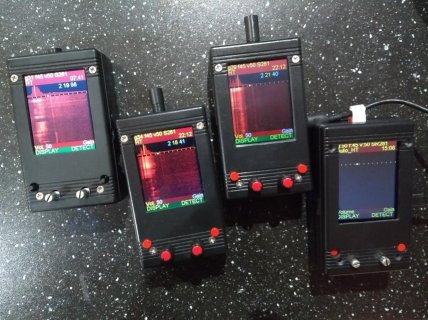

Building a detector
In the past few weeks I have been building a detector using the v0.1 PCB designed by Edwin and using the same box (thanks for the support) he is using.
IMG_20190812_154516216_HDR.jpgirst
The image slows from right to left the different designs I have built over time. The rightmost one is an heterodyne I made several of in the 1980's (Betrik Sikken schematic) using an UST as a microphone and running on a 9V battery. The one left of that is one I made in 2017, again heterodyne but with different hardware inside as some of the chips I used in the 80's were not widely available and running from a powerbank. Left of that, my prototype of the detector we are building since 2018 again running on a powerbank. And leftmost the latest, this is now running from a Lipo battery (1500mAh) and is nice and compact and is according to the wishes of my wife (she was the initiator of my investigations for a new bat-detector). I am still planning to extend it with a small speaker and amplifier so its sometimes possible to share the experience with others.
The power of Teensy is something I had not even heard of until last year.

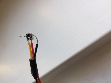

I have been messing with the ICS-40730, I did not like the signal that remained on just about 22-23Khz.
I tried a differential amplifier but the 23Khz signal remained.
After that I took of the little brass lid, shored it and put it back on. There seemed to be a whole lot of space in this box.
Making the metal can smaller had two effects, the 23 Khz signal has dissapered, only to be found on a higher frequency at around 70Khz.
The other effect is lower sensitivity.
Making the metal can around 1mm thick would probably move the noise outside of out detection range, but will also reduce sensitivity even more.
Since I messed up my microphone and did not want to waste any other I do not have any measurements to prove my findings.
Anyway, it seems the 23Khz noise is in the microphone construction, this is probably why there are no ultrasonic properties described in the datasheet.
I hope someone else can prove me wrong, te ICS-40730 seems te have lower noise but I just don't like the noise on 23Khz.

How did you connect the ICS40730? Did you connect anything to the central solder pad ?
Hi Frank,
I am using one of the mics from Edwin so probably the central pad is connected. That 23Khz peak should be associated with something on the board I am quite sure but ... what is still a question. For the detector this is not really an issue as most bats dont go that low and are a lot louder anyway.
Cor
Hi Corbee,
it could well be that the 23kHz noise is associated with the wrong connection of the central pad which must be left totally unconnected in single ended mode. But we do not know if you do not have a closer look at your mic ;-).
Refer to the datasheet for the correct connection or use my photograph in post 418.
It would be very interesting to see a spectrum of your ICS40730 mic when correctly connected.
All the best,
Frank DD4WH
