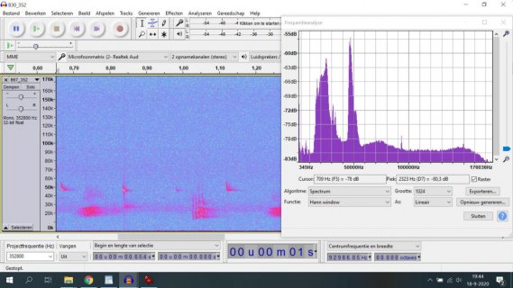

Anyway, for all you curious about my experiments with the FG elements, here are some findings.
I altered a few values in the opamp circuit. The FG element needs quite a bit more gain to produce the same voltgage levels. This is where a low noise design proves to be more important.
(R2 4k7, R4 68k, C1 1nF, C3 3.3nF)
The images below are a recording of the same sounds recorded in my garden.
The top one is the SPU, the bottom the FG
I used the same simple amplifier construction that reduces the low frequencies. People may think that this could cause issues but I had no problems and it gives a much better live experience. If you also amplify the lows quite a bit turning and pressing the controls and walking around become nasty noises. If you use this a as recorder outdoors the whole night without any man made noises in the area you will be fine with an unfiltered amplifier. Specially near roads with car traffic filtering the low sounds is very pleasant. I also did try other filtering but this simple circuit seems te so better than the others I tried.
SPU element
FG element
One can see there is a bit of difference between high and low frequencies. But there is not a huge difference. The big benefit of the stronger output of the SPU can probably be seen in the noise of the FG. Since we only have low amplification with the SPU and much more gain on the FG the noise also seems to become a little stronger on the FG recording.
Since these are two different devices, I guess I should swap the mics and amplifier circuits to be sure there is no hardware difference, but I used the one with FG element with an SPU before and had very similar results as with the other SPU equipped unit.
As far as I can see we do not gain a lot with the FG element, of we should build an extremely low noise amplifier and stay away from low frequency noise sources.

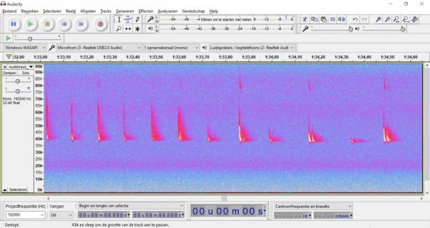

I was playing around with an ALC4040 USB adapter myself because that is quite affordable and allows a sample rate of 192kHz enough for the pips here in the garden.
Using a non inverting single stage op-amp with simple filtering like in the Teensybat detector I got these results.
You can see although I am filtering out low frequencies, there still is a bit more noise on 23kHz. We also did see similar effects on the Teensybat detector. Some people did blame the electronics in the Teensybat detector but it seems it comes down to the SPU microphone element.
