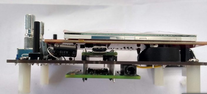

Hi Jim
This shows the way I have mounted one of mine with normal headers instead of resistors.
regards
Cor

Hello Cor,
that is very neat. I hope the noise levels are reasonable. I plan something very similar but am trying to put use sockets so I can remove either board it goes pear shaped again. I found some extra long headers which should allow that. I will post a photo if it works.
Jim

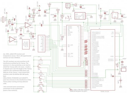

The GPS turned out to be quite a struggle. The code running in the Teensy and all the data lines being switched make a lot of noise. The GPS unit is very close to the busy Teensy and has problems with RFI. You have to shield the Teensy with a piece it tin plate. I bent a U shape and put it over the length of the Teensy.
I soldered it to the GND plane of the main PCB and to the GND pin near the micro USB connector.
I will post pictures later how this fits in the detector. In the attached schematic you can see how the GPS and DS18B20 sensor can be connected.
I only tried a few GPS units. Starting out with ATGM336H I quickly realized GPS reception would be a problem so I also tried a G18U8TTL, Beitian BN-180 and Ublox Neo8. Of these four the Beitian seemed to have the best immunity but I am not done testing. I hope an other NEO7 with antenna on the PCB and a variant like that could work just as well or even better. I am sure your sat-nav (the one you stick to the windshield of your car) will work better. It would have been nice if the GPS was further away form the busy Teensy. If we want better reception in this small box we need to make better shielding or use something that absorbs the RFI.
I hope to be able to post some pictures soon.
Kind regards,
Edwin

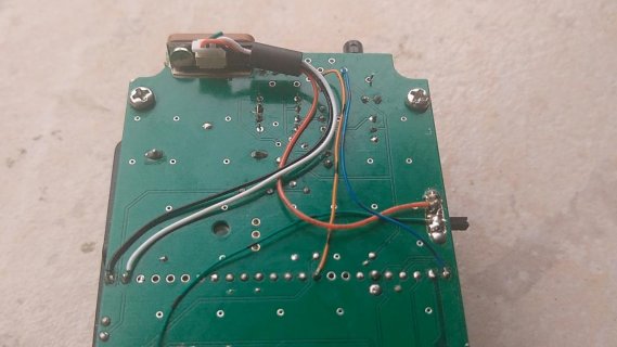

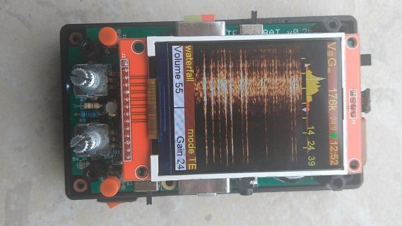

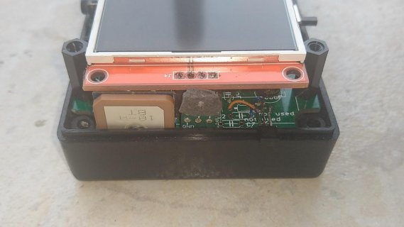

As promised a few pictures....
Notice the ferrtite bead on the wires of the GPS module this to help keep the RFI out. I also use a switch in the GPS powerline. The GPS unit draws quite a bit of curent, if I do not need GPS info I can save battery power.
If someone has the chance to test other GPS devices and fonds one that works better please let us know.
If I wrote something funny it probably was the autocorrupt function in my smartphone.
Edwin

Whoops, I accidentally took out the wrong connections to the audioboard. I don't know how I managed to do that, but this should be the right schematic.
