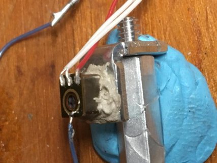

I have been using the Knowles mic, successfully, and am now testing the ICS 40730 mic.
I have soldered it, I believe correctly, but get no signal. I am getting 2.5 V on the inverting output, which doesn't seem right.
The unit is glued with conductive epoxy to an aluminum holder. The case is 0 ohms to the Ground electrode. I soldered a lead to Ground, just in case, after I got no signal in initial tests.
Any suggestions would be appreciated.
It looks like the red wire is ouput -
(Datasheet shows top view, terminal side down)
Are you using both outputs into a differential amplifier?
If you are just using one output, the other should be floating.

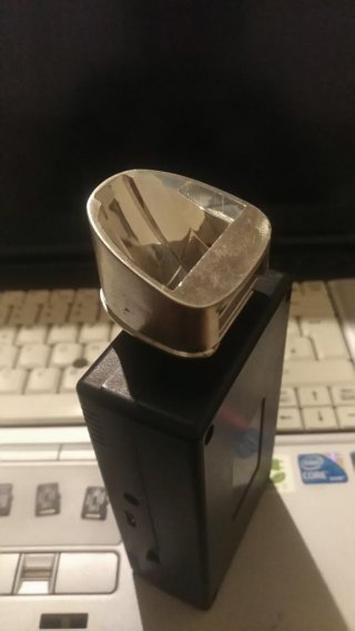

Horn
Ich habe ein Horn montiert, das ist von einer kaputten Fahrradlampe.
Dieses ähnelt einem Fledermausohr und bringt etwa 10db.

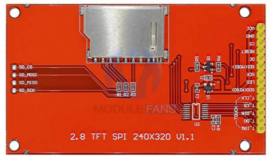

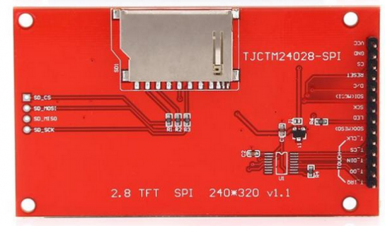

I have tested the usage of the sleep functionality of the ILI9341 display, that seems to work as planned. It will NOT switch the backlight off but it will keep the TFT alive but asleep (alas using less energy). So in order to achieve a real dark screen when leaving the detector out at night a direct switch on the TFT backlight is by far the easiest. Alternatively you could control the voltage on the backlight with a potentiometer as a strong dimmer. In the next update this option will be available, its ment to work ONLY in autorecord mode. You can bring the TFT back alive at any moment by pressing the left-pushbutton (next to the left rotational-switch).
regards
Cor
PS. I will add (or better said reinstall) some code to use PWM (from pin 3 on the Teensy) to allow more control of the LED backlight. For those ILI9341 TFTs that do not have a build in transistor to use PWM a bit of extra electronics is needed to steer the LED. See https://forum.pjrc.com/threads/5686...creen-question?p=209521&viewfull=1#post209521
These are examples of common 2.8" ILI9341-SPI screens
old setup without transistor, so needs additional hardware to use PWM controlled backlight
new setup with added transistor can be directly driven by PWM
