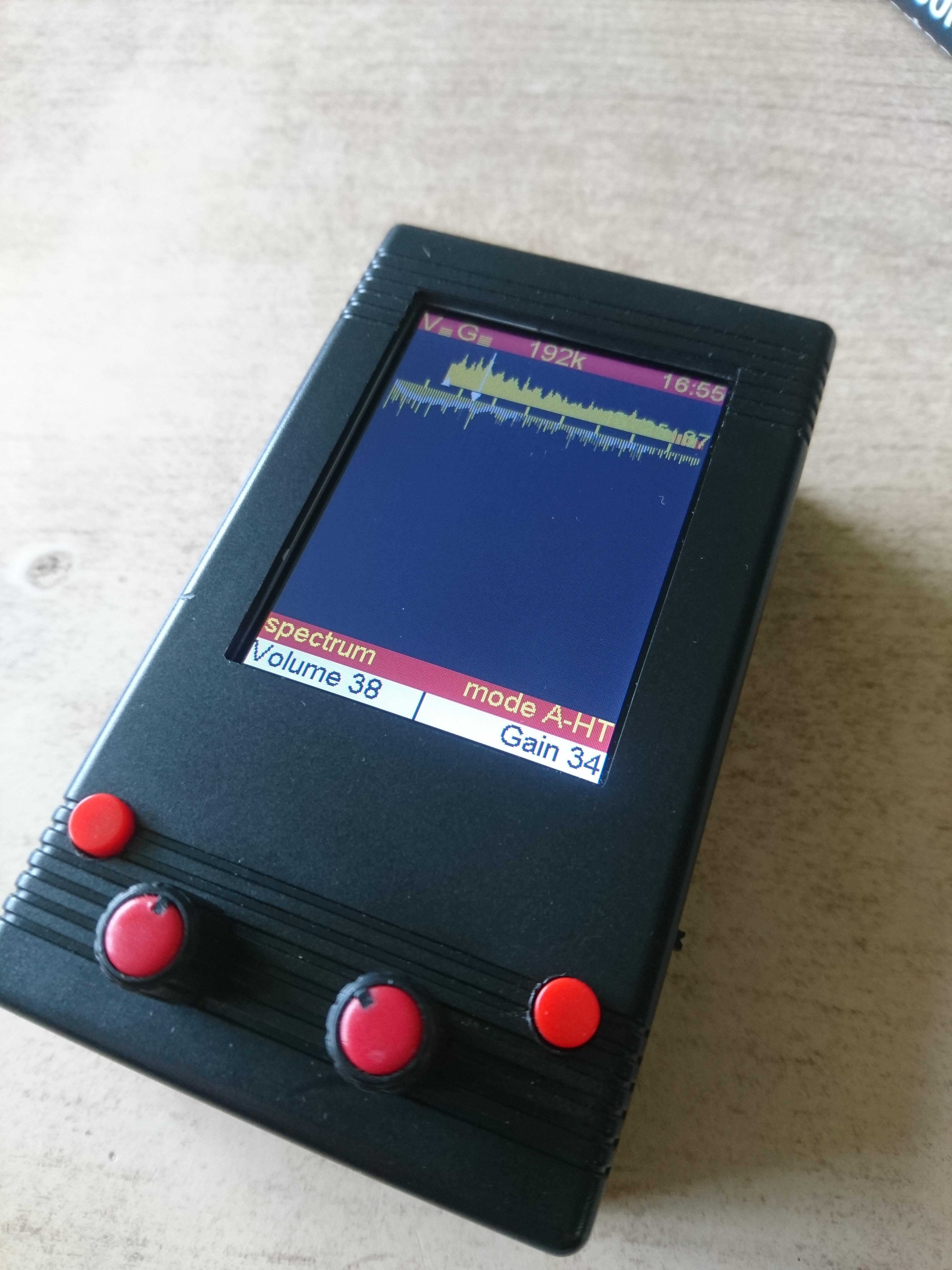

Been playing with the latest firmware (firmware_20210409_v1_1devA) the last few hours and am very impressed again.
But now I have a question, maybe it's a bug or just not intended to use it in this way.
I like to keep the spectrum alive and thus be able to hear soft sounds on the background.
Therefore I set "TE low_peak" to a value of 100~150 and that works flawless in all modes.
Only when entering the TE (or TE-HT) mode the sound mutes in the first second and not comming back easely, while the spectrum or waterfall keeps showing noise.
Sometimes the sound comes back after a few minutes or by pressing or turning a knob.
But when the sound returns it plays well for longer time in that mode, so I think it could be playing all the time.
Hopefully it's a easy fix or something that can be changed with a setting somewhere in the menu.

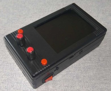

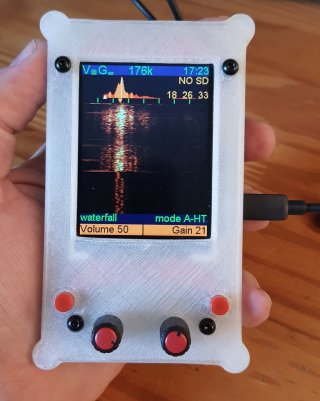

Hi Everyone,
As promised, although a little late, here is my 3D printed enclosure for the device.
https://www.thingiverse.com/thing:4854865
Two backs are available:
1 is a simple cover if you do not plan to have a battery inside the enclosure.
2 is thicker in order to accommodate a 4000mAh battery, its charger circuit and a power switch.
STL and parametric solidworks models included.
Please be aware that, depending on assembly of the circuits, some adjustments might be necessary for the positioning of SD card slot, audio jack and USB ports.
Feel free to use, redistribute, modify, etc.
Any comments or requests welcome.
