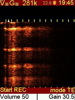

I have a suggestion for coming updates of the software. I would like to have the possibility to choose and indicate a frequency in the waterfall screen.
I think it can be helpful for identification of certain bats.

Thanks for the suggestion but I wonder how that would help identification. But maybe you do have a clear idea for this. Showing a "line" in the graph for a given frequency is in my view not very necessary as we do have a scale on the top of the graph.

I believe the line could help for a quick reference of the different Pipistrelle, Eptesicus and Vespertilio spieces. For me (living in the middle of Sweden) it could help to pinpoint possible rare parti coloured bats among the abundant northern bats (anything below 27kHz is interesting).
Since the scale is on the top of the screen and the sound is first shown in the bottom it is quite long way to aim and "guesstimate" the frequency of the call when it appears.
I have been thinking to put a taped line on the screen but if I change the screen sampling frequency the line will be in the wrong spot.
So if it can be one option in the software I think it might be helpful.

I am not convinced this is going to help much. What I will consider is having a scale at the bottom of the graph to mimick the scale above.
But this does probably not look very tidy. For what I know of bats most species are not that simple to discern by a simple frequency-scale. We have the rythm of the calls (interpulse time), the sweep of the call (hi-lo), maximum peak etc etc. That all are necessary to "guesstimate" different species.
BTW: your screen seems to suggest that you are using an older version with numbered calls instead of the YYYYMMDDTHHMMSS.wav that we have recently added to the software. Which version are you using ?

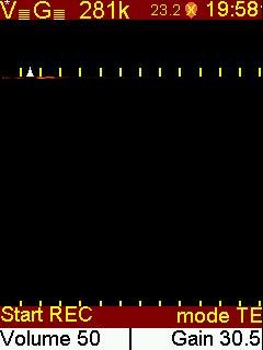

This shows a possible way to allow a scale at the bottom, Ive added this to the current development-code we are working on.
If this stays you can simply set the "bottom-scale" variable with a size, in the example the size is 2. That gives a 2 pixels
high scale. The waterfall will not scroll in that zone so the scale is permanent and will follow the upper-scale.

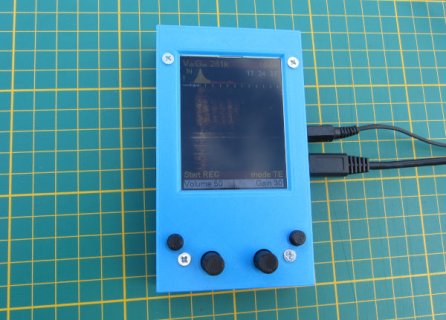

Hi All,
Just a short mail to say thank you for this very cool project and report that my TeensyBat seems to be working ok.
Originally I planned to use the standard box, but designing and printing a custom box would look much better (than drilling holes with my sub-optimal mechanical skills).

Hi
Looks nice !
If you can try to share your works (design etc) so that others that have 3d printers can copy your work.

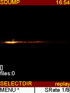

While testing the TeensyBat with the latest firmware 1.2, I found not all SD-cards are created equal; a new 64GByte SanDisk Ultra wouldn't show the directories (writing did work), and an older 8GByte Kingston (formatted to fat32) did show directories, but seemed 'noisier'. Setting Hipass=12 made the 8GB card as silent as the 64GB card.

SDcards come in different sizes but also in different speeds. I only use SDcards with at least SD-HC 1, they allow higher transfer rates than the older cards.

Yes that is useful extra information. The 8GB is a HC I, the 64 GB a XC I.

Hi Cor,
Found a solution; the 64 GB card was formatted exfat. Reformatting it as fat32 made the directory, and its contents visible. This is what PLAY looked like with the 64 GB XC I card (Exfat):
