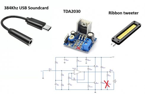

I have a question about ultrasonic speakers.
I've built my own bat detector, and now I want to test it using the audio files from https://www.teensybat.com/bat-species, but I need an ultrasonic speaker to do so, which is difficult to obtain.
Do you have any suggestions on how I can play those sounds?
Hello everyone,
You can play high frequency sounds with a fast USB soundcard (384Khz) and a program lik Audacity, in windows change the sound properties to 384000 Khz for playback.
The USB soundcard can connect to a headphone and you headphone speakers probably have a reasonable high frequency response, but the signal is weak.
Alternatively you could add an amplifier like a TDA20230 board and ribbon tweeter. (I removed the Zobel network from the amplifier)
These USB soundcarsds usually do allow fast playback, but check the specifications. Many do 384Khz, unfortunately recording usually is limited to 44.1 or 48kHz.
