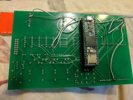

I'm porting a project from Arduino DUE to Teensy 3.6.
The project has five SPI displays.
The board has a single capacitive touch screen TFT (the Adafruit ILI9341 one: https://www.adafruit.com/products/1947) and four ILI9163 displays identical to: http://henrysbench.capnfatz.com/hen...ays/arduino-1-44-in-spi-tft-display-tutorial/
I had it working with point-to-point wiring on the Due. All of the screens are on the same SPI pins and I just chose CS pins based on whatever was available and nearby on the PCB.
With that success, I (foolishly?) had a board made with the Teensy 3.6 footprint and the same pin assignments. No go.
I seem to be running into problems with only certain pins being suitable for SPI, especially CS. I've scratched and patched the PCB to move enough lines around to get the large screen and two small screens working., hacking a bit blindly with the Teensy 3.6 pinout card and various SPI libraries, and various forum posts and rumours. But I can't seem to find pins that will CS the other two screens.
I think I need to start over again.
Would anyone suggest what SHOULD work, as far as pin assignments and suggested libraries? How I should wire the five screens to run them all on a Teensy 3.6?
Performance is nice but not paramount.

Were there proper pullups on all the CS's : five displays and touch?

ILI9341: If you use the optimized library ili9341_t3, it requires two hardware SPI CS pins. One for the DC pin and another for the CS pin. My variation on this library: https://github.com/KurtE/ILI9341_t3n
Allows you to use all three SPI busses on T3.6. I also made it such that it would work with only 1 hardware CS pin, which needs to be the DC pin.
I don't know enough about the ILI9163 displays and drivers available. For higher speed my guess would be Sumotoys driver: https://github.com/sumotoy/TFT_ILI9163C
But I am guessing that it is based using some of the same stuff as the ili9341_t3 and requires hardware CS and DC pins.
What I did with my ili9341_t3n library was to move all of the hardware SPI specific stuff out of that library and into another library I called SPIN, which setup classes for the different SPI busses, which then allowed me in my apps to give a pointer to which one that display should use. It also tries to take care of some other issues like SPI0 has a 4 item queue, where SPI1 and SPI2 have a 1 item queue. Note: this took work in my main code to handle as well, as there is code that would do things like push three commands onto the queue (query pixel) and then pop the three responses, which won't work...
Probably would not be hard to make a version of the ..63 library to do the same.
The sort of confusing things about hardware CS pins, is that while I believe the T3.6 has something like 10 pins that can be CS pins. Some of them are duplicates of others. That is like with the signal MISO0 which is by default on pin 12, it can alternatively be on pin 7 or pin 28. This is true for CS pins as well. That is pin 10 is a CS0, which signal is actually (spi0_PCS0). And likewise that same signal is on pin 26. I believe there are 6 unique CS channels on SPI0. What is means, that for those apps that are using the underlying hardware SPI cs capabilities, like the ILI9341_t3 library, the program can not use both 10 and 26.
Not sure if that helps answer?

What pins might work? Here are the pins for the different SPI0 CS pin channels
Channel: Pins
0: 2, 10, 26
1: 6, 9,
2: 20, 23
3: 21, 22
4: 15
5: 45
Fixed table (pin 20)
Thank you all for replies!
Current status: I've tied the RESET line for all screens high, and compiled with the basic SPI.h from Arduino. I assume it's just bit banged and it works for all screens on any pins.
So everything works and the performance isn't terrible, but I will certainly pursue improvements.
From this thread comments, I am going to try isolating the ili9341 onto the main SPI bus and attempt KurtE's library. If that makes the large TFT fast then I'll see what I can gain from the small ones with the other SPI bus. The little screens have so few pixels though, performance is never that bad
I spent the evening tearing the useful parts off the first PCB I mangled and I'm starting fresh tomorrow on a new one.
