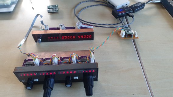

H, Thanks for your reply. I am monitoring the current using a USB current monitor board. Total current drawn is about 40mA so well within the capability of the USB port. I retested the voltages on all the Teensy LC pins and none are above 3.3v. I now think what happened is that I stupidly tried to program the Teensy LC as a Teensy 3.1, and I think that has killed the boot loader in the Teensy LC. So nothing is recognized on the USB port any more (even if I disconnect everything from the Teensy LC (except the USB port).

Hardware set up: each Max 7219 chip drives 5off 7 segment displays using efficient LEDs so current per display is very low and I have also turned down the brilliance to a low level. So when it worked via a single SPI buss there are 35off 7 segment displays. drawing approx. 50mA. I added a further 2off Max7219 chips driving 10 off 7 segment displays via what I thought was the second SPI buss on the Teensy LC (pins 0, 6, and 20). but during programming I forgot to reset the chip type from Teensy 3.2 to Teensy LC and tried to program an LC as a 3.2. If I re-plug the hardware from SPI1 to SPI0 and run it, the hardware works fine on a Teensy 3.2. But I believe I am right in saying the Teensy 3.2 does not support a second SPI buss??
Photo: The front unit is showing frequencies from aircraft Com Box 2 and the rear unit (upside-down) is showing DME Distance, speed and time. I think I need to do more work on the time calculation :) .
