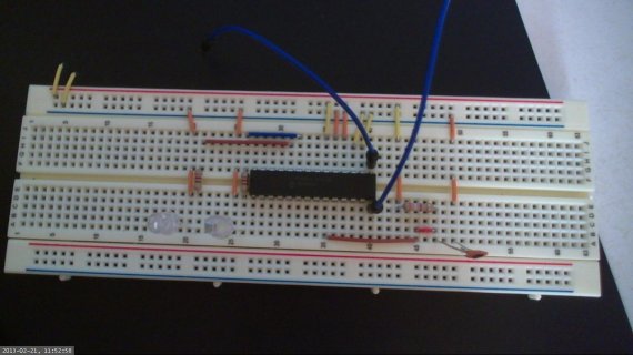

I am trying to turn on 2 leds using an MCP23016, but I haven't been able to get them working yet.
I have connected everything like this example states.
I connected the bottom blue wire to SCL/pin A5 and the top blue wire to SDA/pin A4
When I remove the lines from pin 23 & 24 on the MCP23016 and connect a jumper between the 3.3v and the two resistors, the leds turn on, so the leds must work.
To make them light up, I am using the following code:

If I understand the process right, both lights should light up one after the other and each lights for a period of 500ms
It should be pretty straight-forward so I don't see where I am going wrong...
I have been using the supplied resistor/condensator, but I do notice that the condensator looks a bit different and is not blue as the product description suggests.
Am I wrong in using the supplied parts, are these meant for 5v perhaps?
Resistor 3K9 Ohm
Condensator 33 pF
What kind of test equipment do you have? I'm not sure about the code aspect, but verifying the clock is present on the port expander will at minimum require a logic probe so you can verify there are pulses present on the TP pin. Though you'd need a scope or a logic analyzer to see exactly what those pulses are.

I have been looking at Open Workbench Logic Sniffer and the Scanalogic-2 Logic Analyzer, reasonable choice or would you advise something else?
I also want to mention something else, because I have done another test after reading this post.
When I use Teensyduino beta 10 instead of the latest version I do get blinking lights on 23/24 (yay!), but the example seems to stop after 5 loops.
I added 2K pull-ups and things went from flakey to functional.
Can I (safely) try to reproduce these findings, or is there a chance of damaging my Teensy?
Well, I figured I should at least try and find out what happens, worst case scenario I'll just have to order more Teensy's, which I am planning on anyway.
I tried, and it works also on the latest beta!

Congrats on the progress, but even a $25 logic probe can be invaluable. Useful test equipment doesn't always have to be expensive. If you were here in the states i'd suggest just getting a cheap surplus tektronix scope from a local hamfest.. But i'm not really sure that'd be an option for you heh.

I tried to use beta 10 to see if it would work, which it did, after that I went back to 1.12 with the added resistors.

Hmmmm, after running my compass example for about 15 mins, the program hangs and needs to be rebooted.
After reading up some more, I noticed a post by Paul that mentions 1k pullups instead of 2k.
I made the change, and my compass example hasn't stopped working yet (2hrs runtime now).
