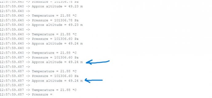

- I'm using bmp280 with teensy4.1. in rocket flight computer. the flight computer code is as below. the bmp is supplied by 3.3volt.
bmp280showed different altitude result for same place as it appears in photo the altitude now is 41.3 meter but in morning it was 32 m and before 2 days it was 45.
Note: the pressure was Adjusted to local forecast!>>>>>Serial.print(bmp.readAltitude(1019)); /*

Very confused on what you mean by false result - if you mean that your reading will be different from day to day or hour to hour. Yes it will be if you don't update your sea level pressure for the area close to.... Note the sea level reading will also be varying just as a note but it looks like you have sea level pressure fix at 1019mb.
The 1019mb is the standard sea level pressure but you need to use the one for your area. For instance I have a major airport (LGA) near me so I use METAR data (https://aviationweather-bldr.ncep.noaa.gov/metar) from the airport. For me right now sea level pressure is 1013.4mb not the standard 1019.
Other note is that the higher the oversampling rate is for pressure and temperature the more accuarate the altitude so you need to make adjust accordingly. Even with that you altitude will not be absolute - may vary by as much as 0.3meters or more depending on your settings.

Are we sure elevations will be the same even if in the same location? I'm pretty sure these units compute elevation from pressure. The constant passed into readAltitude() simply compensates for atmospheric pressure at sea level. The problem with these units is using pressure to compute altitude--namely because pressure changes frequently--especially from changing weather.
Here are results from my BME-280 sitting on my desk for 60 minutes. Notice the 7 feet of elevation difference even though the unit is in a static location. I've even tried other sensors such as the MS583702BA01-50 (13cm altitude resolution), but the same issue. I've had to add "zeroing" code to get a reliable starting point.

yes the atached result photo was for the my flight computer code which includes bmp280 also. here in this atached file i gave a result from i2c example of the adafruit bmp280 library and as it aoears the altitude is 49 meter while it was 41.3 in past photo.

thanks for your widly explantation. the sea level pressure on my place was 1019 as i saw it on weather website and today it is 1018 in some websites and 1020 in others. the problem is even i put 1018 in the code the result still varying but in small range(2 or 3 meter). so the question is, how i can control my rocket in the air and make it stable if there are 2 or 3 meter varies in altitude detection? and there is a way to make the sensing more precise?
