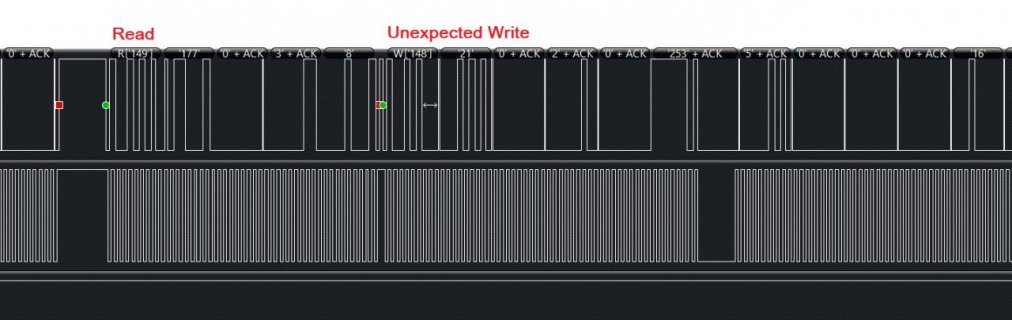

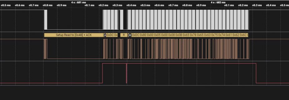

Hello there!
We are trying to develop our own code to read data from a BNO086 IMU by CEVA, using I2C and Teensy 4.1. We read the datasheet and understood all the main points of the CEVA's SHTP and SH2 protocols. We are able to open the communication and to read the first advertising messages that BNO086 send to the host at startup. After this, we are going to write the command on CHANNEL 2 to enable the output of Rotation Vector data with a 10ms update time, and here starts the pain. After the write, we perform the reads when interrupt form BNO086 goes down. The data are delivered correctly, but between the Rotation Vector buffers, we receive a lot of messages from CHANNEL 0. We figured out that those messages are about the list of errors that BNO086 has experienced since the startup. What we discovered is that:
1) Running the SAME code on an ESP32 DEV-MODULE, no error packets are sent from BNO086
2) Running an analysis of the packets with Saleae Logic, we can see that the problem is that after the first write to enable the output, while we are reading the Rotation Vector packets, in the middle of the reading another unexpected write request happens, but we are pretty sure that this write request IS NOT inside our main code. So we think that maybe the library could have a sort of bug, because we can't figure out who is to make this request.
3) If we set the the output, get the errors and then we reprogram the teensy with the reset button without powering off BNO086, magically the errors vanish and all is fixed.
I'm going to attach both the codes for Teensy 4.1 and ESP32 and some screenshots and files from Logic analysis.
Logic Analyzer log generated with Logic 1.1.15
View attachment BNO086 Logic Analysis and Arduino Code.zip

Thank you very much in advance for your time and support.
Andrea Moreschi, Ecodrone SRL
Was poking around but could not find an associated breakout board. But I did notice from the hillcrest website that said the 086 is backward compatible with the 080 including existing software. You might try using the sparkfun bno080 library just as an experiment to see if you get the same behavior. I also believe you should be running at 100mhz on the i2c bus.
It might also be a timing issue. I know when I was originally experimenting with the t4.1 and the bno080 I added some delays after the reads. But Paul put some fixes into the i2c lib to fix the issue. But it sounds like you are running into that now.
Thank you for your answer,
Our read and write methods are basically the same as the Sparkfun library. We tried that library immediately to see if the chip worked fine with the test board that we designed, and we tried the Adafruit one too.
We read also the previous and long thread about BNO080 but we didn't find any solution to this problem. We are pretty sure that the problem with the chip is in the writing procedure, but we don't know if it is an hardware, library or sketch problem. The fact that on ESP32 the sketch runs perfectly is suspicious and suggests that something could be wrong in the I2C library.
A BNO080/85 breakout board would be useful to test our methods and to undestand if something changed with the 086 version of the chip, but unfortunately they're out of stock everywhere...
Ecodrone
Ecodrone
Good to know. Its hard to debug this type of issue without having hardware to test with as I am sure you know. But a guess is a timing issue, remember Teensy 4.1 is running at 600mhz. In going through the BNO080 thread noticed that the issue was primarily with i2c clock stretching.
You also might want to check this post out: https://forum.pjrc.com/threads/5826...-3-6-gt-gt-4-0?p=225042&viewfull=1#post225042 on where I had added delays. Also noted in that thread it seemed to work better at a something other that 600mhz - you might want to try 528mhz or lower.
PS As soon as i find my bno080 I can give your sketch a try and see what happens.

In addition, I post a screen of the detail where in our opinion lies the error, or that Teensy periodically sends unwanted write requests (containing the buffer of the last request actually executed in the sketch) during the periodic reading of the data. In our opinion, this is a misbehavior due to the Wire library or Teensy itself.
The I2C protocol is designed to receive a response to a request for a specific register. Unexpected writes come immediately after a read, so we suspect that there is an algorithm in the Wire library that repeats the write in case the response read is not what one expects.
Ok, found a workaround and the problem is clear!
When I write the request to enable the output of the Rotation Vector, if I add a beginTransmission to a different address and then make an endTransmission, the errors disappear.
uint8_t sendPacketI2C(uint8_t channelNumber, uint8_t dataLength)
  uint8_t packetLength = dataLength + 4; //Add four bytes for the header
  Wire.beginTransmission(deviceAddress);
  shtpDataSend[0] = (packetLength & 0xFF);
  shtpDataSend[1] =(packetLength >> 8);
  shtpDataSend[2] =(channelNumber);
  shtpDataSend[3] =(sequenceNumber[channelNumber]); //Send the sequence number, increments with each packet sent, different counter for each channel
  for (uint8_t i = 0; i < (dataLength); i++)
      shtpDataSend[i+4]= shtpDataWrite[i];
  for (uint8_t i = 0; i < (dataLength + 4); i++)
      Wire.write(shtpDataSend[i]);
  sequenceNumber[channelNumber]++;
  Wire.endTransmission();
  memset(shtpDataSend,0,sizeof(shtpDataSend));
  Wire.beginTransmission(0x4B); //WRITING TO A FAKE ADDRESS WORKAROUND
  return true;
So our suspicions are becoming more and more founded, namely that the Wire library makes unwanted writes by itself, probably to repeat the last message written for which it did not receive the response it expected. By doing any write to a different address on the bus, something internal to Wire is reset and the unwanted write request is no longer read by the BNO but probably repeated all the same.
Probably within the Wire library, if after writing the same address is not read in the response, this continues to write the last message after the first reading. It is a problem to be solved for particular protocols on I2C such as SHTP of BNO08x devices.
To use this protocol with I2C, which is blocking both in reading and in writing, it would be ideal to solve the problem of the rewritten message and insert functions that support DMA, and therefore non-blocking (asking Roll, Pitch, Yaw, AccXYZ, GyrXYZ, MagXYZ at 100Hz the I2C bus is full and consequently the loop is blocked).

Are you experiencing the error messages between data readings or with this startup procedure is all fine and you get the data packets only? Thank you!
With the sketch I posted in post #17 I am seeing what appears to be a counter between reports as I showed in post #15:
[COLOR="#FF0000"]17,0,3,6,[/COLOR]
23
17,80,3,7,FB,15,0,0,0,5,8B,0,0,87,2,DB,1,15,D0,4F,2A,44,32,
[COLOR="#FF0000"]4
17,0,3,8,[/COLOR]
23
17,80,3,9,FB,12,0,0,0,5,8C,0,0,87,2,DB,1,15,D0,4F,2A,44,32,
[COLOR="#FF0000"]4
17,0,3,A,[/COLOR]
23
17,80,3,B,FB,14,0,0,0,5,8D,0,0,87,2,DB,1,15,D0,4F,2A,44,32,
[COLOR="#FF0000"]4
17,0,3,C[/COLOR]
23
17,80,3,D,FB,12,0,0,0,5,8E,0,0,87,2,DB,1,15,D0,4F,2A,44,32,
which I believe matches your correct message format in post #8.
I have not tried @KurtE's sketch in post #21 but will.
With @KurtE's sketch on a BNO080 once I request the report I see that data as shown in previous post.
uint8_t readI2C()
  switch(syncCom)
    case 0:
      byteToread = Wire.available();
      if (byteToread >= requestBytes)
        Serial.println(requestBytes);
        for (uint8_t k = 0; k < byteToread; k++)
          shtpDataRead[k] = Wire.read();
       [COLOR="#FF0000"] Wire.endTransmission();[/COLOR]
        printPacketI2C(requestBytes);
        remainingBytes = getRemainingBytes(shtpDataRead[1],shtpDataRead[0]);
        Serial.println(remainingBytes);
        if(remainingBytes < (MAX_BUFF_LENGTH - HEADER_LENGTH))
          requestBytes = remainingBytes;
          syncCom = 2;
Aren't these calls to endTransmission superfluous? The read is terminated by nacking the last read. The library then puts a stop on the bus.
A call to endTransmission does send something, looking at the code in the library:
uint8_t TwoWire::endTransmission(uint8_t sendStop)
  // transmit buffer (blocking)
[B]  int8_t ret = twi_writeTo(txAddress, txBuffer, txBufferLength, 1, sendStop);[/B]
  // reset tx buffer iterator vars
  txBufferIndex = 0;
  txBufferLength = 0;
  // indicate that we are done transmitting
  transmitting = 0;
  return ret;
