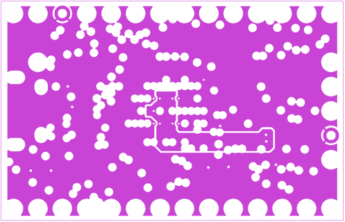

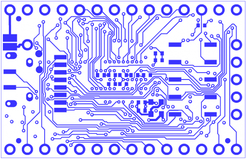

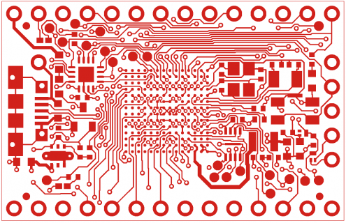

Here are some images and files of the early Teesny beta test board, which might help for "inspiration". It was routed using only 4 layers and only slightly larger than the final Teensy 4.0 size.
These are the 4 layers:
This was an early prototype where only about 25 boards where ever made. The BGA was soldered by a CM, then Erin a.k.a. "Soldering Goddess" and I hand soldered all the rest of the parts based on hand-written notes, where are long since gone. There isn't any documentation about which parts are which, but it is pretty much the same schematic at Teensy 4.0 (the 100K resistor on PMIC_ON_REQ might be different... that was one of the gotchas on this prototype...)
There is no BOM, schematic or even parts placement diagram. But at least this can help you visualize a possible way to do the layout using only 4 layers and a "normal" PCB process.
Here is a ZIP file with the gerber files ready to use with OSH Park or other PCB services, if you want to make this PCB.

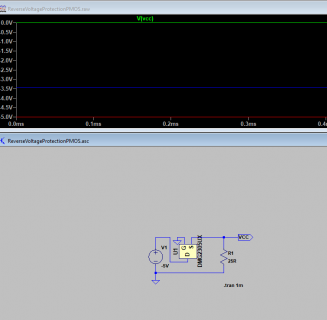

Something that always intrigued me is that the mosfet (dmg2305ux) is always on (as the gate is always at GND level), is it only there for a kind of reverse polarity protection circuit?
EDIT: Must be that the dmg2305ux P-Channel mosfet features a very low Rds(ON) an ltspice sim showed me only a 4mV voltage drop with a load of 25R, much nice than if a shottky diode were used (see simulation below)DMG2305ux.PNGReverseVoltageProtection simulated.PNG
Simply said rather than in my previous message: the dmg2305ux role seems to be that it allows for reverse polarity protection while not causing a significant voltage drop and not causing significant current consumption/limitation as when compared to using a diode (8mV drop actually not 4mV in the simulation, still much smaller than usual hundreds of mV drops with diodes).
Yes, exactly, it's for reverse polarity protection.
This is what is known as an "ideal diode" circuit. It acts like a diode with a very low forward drop. In the forward direction the P mosfet is biased on and the voltage drop is = RDSon * current, which is usually specified to be as low as device cost / size permits. In the reverse direction the Mosfet is biased "off" and its internal body diode is also reverse biased so the device blocks current flow.
