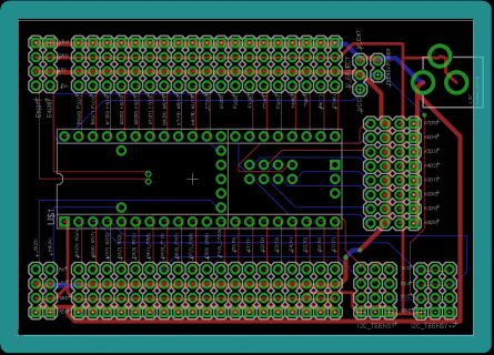

I develop Maxuino, a connection arduinos and Cycling '74's Max. We're about to release a major update. In the process, I've sketched out a breakout board for the teensy2 or teensy2++ (plans for teensy3 also) serves two purposes:
-Make it easier to connect LEDs, SERVOs and SENSORs to the teensy
-Facilitate testing of multiple input/multiple output scenarios
-Provide a connector for external power (for powering the teensy, or servos/steppers/motors)
I'm partly inspired by things like the Modern Device BBLeo or available IO Shields for the Arduino Nano like this one from RobotShop.
There are two simple boards:
-Teensy-Maxuino-Master: expose all teensy2/teensy2++ pins as 4-pin connectors, along with Ground, VCC and V_Ext

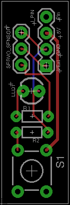

-Teensy-Maxuino-Slave: simple tester with 3-pin servo/analog-sensor, 1xLED, 1xBUTTON
I'm planning on additional slaves for:
-Stepper driving using the EZDriver or the Pololu A4988 (uses two pins from teensy)
-Dual bidirectional motor driving using Pololu DRV8833
I'm planning on sharing all designs as freely/opensource through my lab (ArtFab @ CMU)
I'm looking for guidance, suggestions, requests, or ideas on this project.
Would be delighted to hear from anyone out there with common interests.
Thanks in advance,
Ali
