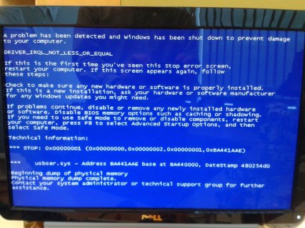

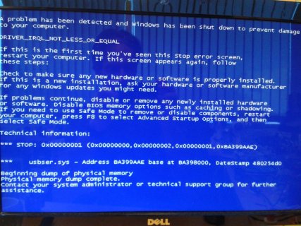

I'm using Teensy 3.0 Windows Beta 6 (Oct.19 2012) on Windows XP Pro Version 2002 SP3 (32-bit). The Arduino environment got locked up for some reason, so I killed Arduino and Teensy Loader from task manager, and unplugged and re-plugged the USB connector on Teensy 3. I restarted Arduino and pressed the black button on Teensy and the bootloader showed the normal "Reboot OK" sign. So far, so good, but when I opened the Arduino serial port I got a BSOD. This also happened twice a few weeks ago on an earlier beta, and I think the sequence of events was the same but my memory is fuzzy.
EDIT: happened again today. It was at the moment of opening the Arduino serial monitor.

EDIT: Teensy not bricked- works and re-loads normally when connected to differerent USB port on same PC.
At first I thought my Teensy 3 was dead. The computer no longer saw it as a serial device when connected via USB, and pushing the small black button no longer caused the bootloader to respond. As far as I could tell, it was actually still running the last loaded sketch (after a five second delay on startup, generates SPI clock signals on pin 13, as intended) but the bootloader seemed to be kaput.
Of course to confirm this I'll need to try it on a different computer... Ah, it still does work on another port! First USB port on PC went bad? can the OS "blacklist" one particular USB port? That might make sense, if the PC remembered that a specific port and/or device had caused a BSOD.
Ok, this may be just an issue with one particular computer. After the earlier two BSODs today, I had my Teensy 3 happily acquiring data and sending it via USB to PC and it had been doing so for about an hour. At that point I connected my Canon S95 camera to a different USB port, and immediately got a BSOD! I have had that camera for several years, and this never happened with it on this or any other computer. Probably something messed up on the PC I'm thinking.
