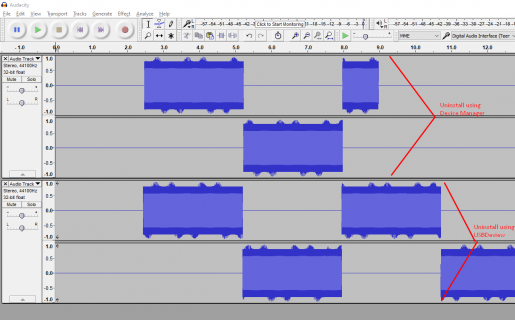

Windows can act very strangely when a previously used USB device changes its audio config. I would recommend getting USBDeview and fully removing any existing driver instances of the Teensy from the PC.
I was using Device Manager to uninstall the device driver which seemed to do the trick. When I would make changes to the Audio library and then did my "Testing Audio Library Changes Steps" above, then I saw changes in the recorded sine wav audio. Just to be sure, I did the same steps again but one time using Device Manager and another time using USBDeview to remove the Teensy driver. As shown in my screenshot below, the audio files for both methods still show the buzzing/unexpected distortions so I don't think it is a Windows driver caching issue.
