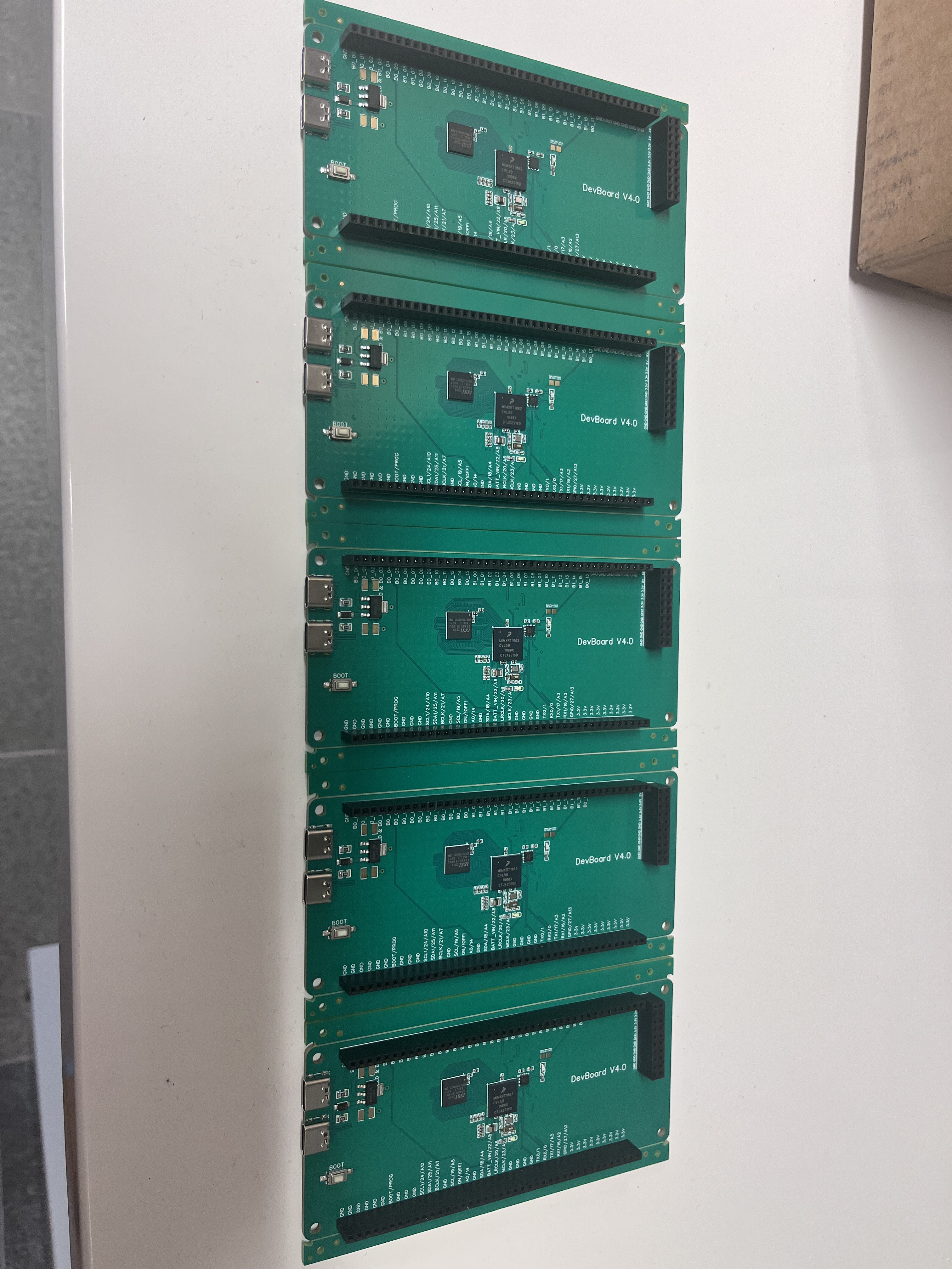

I'm trying to order the pcb through jlcpcb
The parts list for defragsters board shows an IMXRT1062DV_10X10
The only imxrt1062 jlpcb is showing in stock is MIMXRT1062CVL5B
Datasheet shows its the 10x10 chip. Will this work?View attachment 32891
Sorry for late reply. Any 10x10 footprint that’s 1062 chip will work. The CVL5B is the exact one I use!

I'm considering adding photos to those "User Shared Projects", so it will be visually interesting rather than looking like a footnote at the end of a long page.
@Dogbone06 - Do you have a photo I should use? Or should I just grab something from a prior message?
