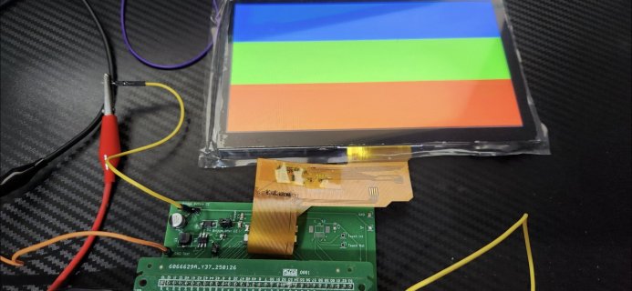

So using dogbones board im driving a controllerless 800x480 display from buydisplay.com
I've made an adaptor pcb with a constant current driver for the backlight as well as a 40 pin ziff connector (had to hand solder, forgot to click the stencil option)
So running in dotclock mode (using hsync, vsync and enable) im running a 20mhz pixel clock with a screen refresh rate of 50hz. A front and backbuffer is in sdram, and these are both being driven out to the lcdif pins via the lcd engine.
This works fine so far (except im missing the first 4 rows of lines being displayed) ive tested using a 32 bit buffer (with 3 bytes per pixel) and rgb 565 16 bit buffer.
The lcd engine actually does alright getting the buffer out of sdram into its own buffer in a timely manner.
Without the lcd engine running, In sdram using a for loop to fill uint32_t 384000 element array was about 4 milliseconds. When running the lcd engine outputting to the display and filling this array - this only increased slightly to an extra half a millisecond (I expected worse - sdram read to lcd buffer must be quicker than sdram read to cpu)
However there's 1 problem I can't solve. The display uses ST7277 to drive the actual pixels.
Whether im in 16 bit mode or 24 bit mode, if I have full white in the buffer the display goes wierd. It has to be full white. The whole display can be the colour 255,255,254 and its fine
If I add 5 rows of 255,255,255, those rows will have black artefact lines randomly flashing through.
If I add 40 rows of white, the artifscts are worse, and every couple seconds the display will randomly flash with junk colours.
Yet as long as there's no full white pixels everything is fine. It's extremely strange.

I'm also driving an 800x480 display with the ST7277. I had issues similar to what you described but was able to resolve it.
Here are the settings I ended up with:

And then I needed to set the dot clock polarity bit in the LCDIF_VDCTRL0 register:

It sure did!!!!
10 hours of trouble shooting this and you have just solved it.
i needed to set the DockCLK Polarity.
I also needed to reverse the polarity on the Vsync and HSync to get it to work

I was starting to think the ST7277 was faulty. All the data signals where coming out correctly on the scope yet the screen was a mess as soon as i had full white pixels on it.
I seem to be missing the first row of pixels, but ill see if playing around with the porches will fix that
