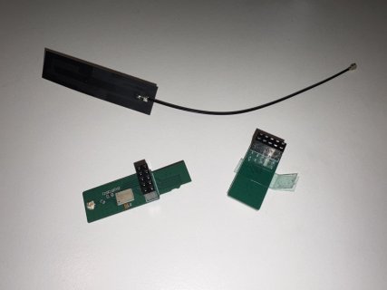

I'd love to help more, but I think I need some hardware. Could someone send me something or tell me what to acquire? (If I don't already have what's needed.) Here's what I already have: (image attached). One board has the chip on one side, and the other board has the chip on the other side; the silver chip is labelled SS2211007 1DX. There's also an antenna. Is this the correct stuff?
correct stuff
Yes, that is the right '1DX' chip. You have TWO variants it seems. One wired to SD Socket adapter - ignore that for now. [this could work but would require altering the code to move to alternate SDIO and adding the INT wire IIRC]
With the Other look to post #73 : https://forum.pjrc.com/index.php?threads/call-to-arms-teensy-wifi-true.77099/post-366611
Photo there and wiring notes should find matching small print names on the silkscreen bottom side with no components.
 // wiring used from prior post: Viewed chipside up header connector to the left
INT (34)    WL_ON (33)
CMD (22)    CLK (23)
D0 (40)     D2 (17)
D1 (41)     D3 (16)
GND         3.3v
In that photo is a set of 10 4" jumper wires MALE on one end and Female on the other. Using that Male '1DX' board socket the Female wire ends went to Male pins on an otherwise bare T_4.1.
Progress down the T_4.1 from GND, then 3.3V and so on connecting wires to the indicated pins.
Then one wire at a time connect the Male wire ends into the properly identified Female header pins as indicated.
Carefully attach/Press the Antenna on the small round connector.
With that complete: The @wwatson github code examples should run as indicated in posts on the page prior to #73.
The only added hardware parts you might need for that are a Male pinned T_4.1 and the M<>F jumper wires - shorter is better.
Of course, a Female headered T_4.1 works as well with M<>M set of jumper wires.

Indeed, hardware in short supply. @PaulStoffregen collected a series of commercial variants, not sure where that is in the queue,
Connections documented prior page of this thread as used on the T_4.1 with 'raw' @Dogbone06 board: https://forum.pjrc.com/index.php?threads/call-to-arms-teensy-wifi-true.77099/post-366611
Only the single raw, not the SD adapter, version of hardware here with the 1DX for any testing.
You also have a WiFi chip right? Would be nice if you could test it out. It will take weeks before I have one to test myself.
ReadMe is @shawns ReadMe
Okay - kudos to @shawn for that on QNEthernet then - that explains not seeing any hardware connect or details specific to 1DX :)
Yes, See link in p#96 that hardware is here and was used for early testing Mar 19, 2026.
Hoping the pins/names noted there match one or more of the hardware items @PaulStoffregen has on hand when he gets back to it for easy connection.
