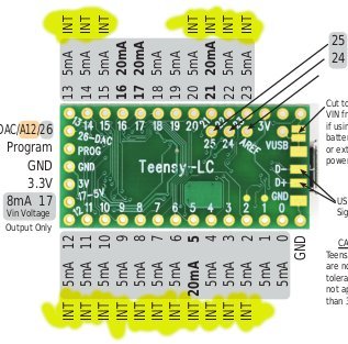

theoretically, the teensy lc has the inputs to do this
27 digital and 13 analog
from this:
https://www.pjrc.com/teensy/td_libs_Encoder.html
I see that each encoder uses 2 digital pins on the teensy. but that document makes the distintinction of interrupt pins and non-interrupt pins.
Best Performance: Both signals connect to interrupt pins.
Good Performance: First signal connects to an interrupt pin, second to a non-interrupt pin.
Low Performance: Both signals connect to non-interrupt pins, details below.
The teensy documentation does not seem to distinguish between interrupt and non interrupt pins. Can someone enlighten me?
for the display, i imagine i need to store the images somewhere. the teensy lc only has 62 k of flash memory (what a weird amount- why not 64?) and then some of that memory needs to go to storing the arduino sketch. do i need to upgrade to the teensy 4.1 to use its 256 k of flash? or should i have a separate solution to manage the display?
