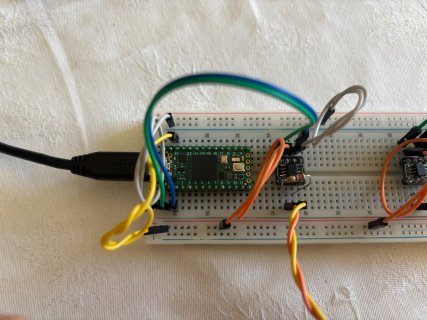

Hi everyone,
I’m having trouble getting two Teensy 4.0 boards to talk to each other over CAN using SN65HVD232D transceivers. Internal loopback passes on both boards, but nothing is received over the physical bus.
Hardware Setup
ItemDetails
Microcontrollers2 × Teensy 4.0
Transceivers2 × SN65HVD232D
Termination120 Ω at each end
CAN pins testedCAN1 (22/23) and CAN2 (0/1)
Wiring (SN65HVD232D)
Transceiver PinConnection
1 (D)Teensy CAN_TX
2 (GND)Ground
3 (VCC)3.3 V
4 (R)Teensy CAN_RX
6 (CANL)Other transceiver CANL + 120 Ω
7 (CANH)Other transceiver CANH + 120 Ω
8 and 5 (NC)Nothing

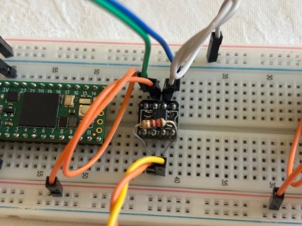

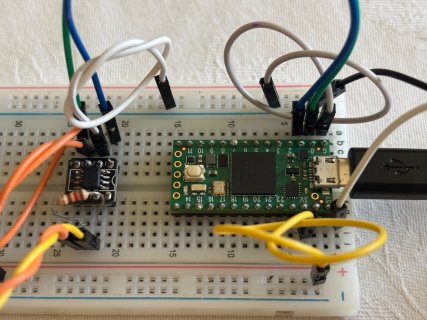

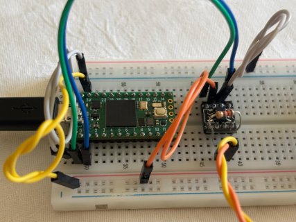

I would check the soldering on the SN65HVD232D. They don't look too good. Add some flux and reflow them.
You can't use the MCP2551 as it is 5v logic device. You will damage the Teensy.
You can use MCP2562.
Thanks for pointing that out – I did go heavy on the solder. Continuity checks passed, but tht does not guarantee good high-speed signalling right? I’ll try to reflow the SN65HVD232D pins with flux and tidy them up with wick, then test again, i just didn't have a good soldering iron or skill aswell.
Yeah my bad i will try the MCP2562s if nothing else woks.
No decoupling on the chip's supply? 100nF across pins 2 and 3 is needed.
Thanks! I honestly didn’t think a 100 nF cap was necessary. Could you explain why the transceiver still needs its own capacitor right next to pins 3 (VCC) and 2 (GND)? I’d love to understand it better. Thanks again for the help!
I use the SN65HVD232D without any issues with the T4.1 on CAN 3. If you are by chance using the 231 or 230 variant instead of the 232, try grounding pin 8.
The decoupling/bypass capacitor across the chip power/ground pins is good design practice. With most circuit boards you will notice that at least one is put near virtually every chip.
The purpose is to provide a localized source of instant current to help handle any surge demands the chip may have and also helps to filter out noise on the power pin. This is even more important when the power is coming down a relatively long wire instead of a power plane right under the chip. Since your setup isn't working at all, it may not be the root cause of your issue, but it would still be good design practice to add one.
In fact the TI data sheet calls for both bypass and bulk capacitance near the power pin, so the chip may create fairly large power transients during switching. If you have a 1-10uF cap you might try tacking that on as well to see if it has any effect.

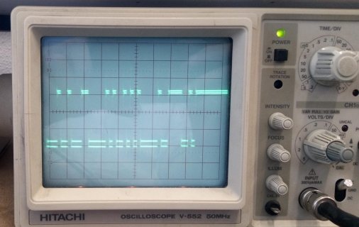

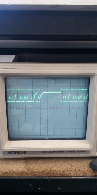

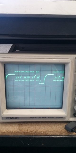

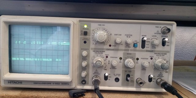

Quick update—even before I re-flow anything or add the 100 nF caps, I wanted to see what the bus actually looks like. I got hold of an old Hitachi V-552 (50 MHz) and scoped the lines exactly as-is (no solder rework, no extra decoupling, same breadboard wiring).
I grabbed four photos—just drag-and-drop them below (they’re the ones named osc2, osc3, osc4, os.jpg):
Shot #Probe pointWhat you’re seeing
1Same as #4 but zoomed-outRepeating 0x123 frame @ 125 kbit/s (overview)
2CANH/CANL right at the TX SN65HVD232DDominant ≈ 3.3 V / 1.3 V, recessive ≈ 2.5 V
3CANH/CANL right at the RX SN65HVD232DLooks basically identical to #2 → bus reaches 2nd node
4Teensy pins CTX (CAN_TX) & CRX (CAN_RX)CTX toggles, CRX stays recessive → no ACK
Observations
  • Edge speed looks a bit lazy (~2 µs on this analog scope).
  • Voltage levels seem in the ballpark (3.3 V / 1.3 V dominant, ~2.5 V recessive).
  • Still zero traffic getting through to the Teensy’s CRX pin.
Questions
  1. Are those edge times way too slow for 125 kbit/s, or is this just the scope bandwidth?
  2. Does the fact that CANH/CANL look good at the RX transceiver but not at CRX means “bad solder joint on the transceiver’s R-pin”?
Thanks again—just wanted to share real waveforms.

No termination resistors? That's very slow recovery The recessive state looks wrong too, should be about mid-rail. One end seems to have much stronger drive than the other I think. Look at the 'scope shot at the end of this wikipedia page to see what you should expect: https://en.wikipedia.org/wiki/CAN_bus
But I see the two 120 ohm resistor in the photos, so its mysterious...
Might be worth getting screen captures for each side independently to check both CAN chips are behaving the same.
[ edit: But thinking about the differential signal, its clean and this untidy waveform shouldn't be preventing communication - the datasheet mentions the recessive state is not symmetrical, I guess the recessive bias network is very high impedance to give those slow exponential decays, not that there is much common-mode capacitance on a 100mm CAN bus segment! ]
