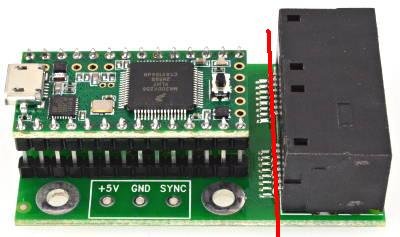

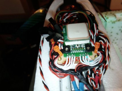

I would like to cut off the RJ45 connectors and simply solder the signal wires directly to the OctoWS2811. Ground and positive wires will be all soldered together to an appropriate power supply.
Am I going to cut something I can't see if I go along the red line in the picture?
Thanks

Yes, it should be ok to cut, as long as you have the soldering skill to connect to the small pads.
The 8 signals connect from the left side, so you shouldn't lose any of the signals.
The 8 ground pins connect from the right side, so all 8 ground wires will disconnect when you cut the PCB. Make your ground connection at the GND pad in the lower center of the PCB, or at any of the 4 mounting holes, and it should work.
OK thanks alot.

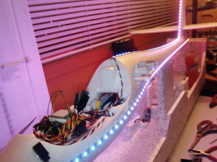

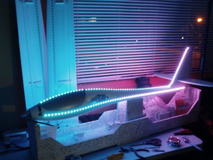

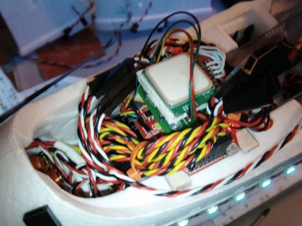

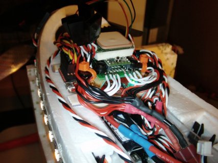

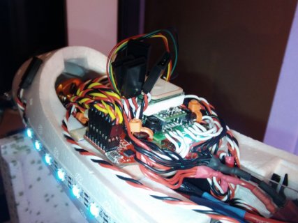

I did the cut, removed the 8 ground pins completely and then soldered 8 new signal wires that go to 8 radio controlled type plugs. These have 3 wires (pos, neg and signal) so they are perfect cabling to power WS2812b LED strips. 22Ga is sufficient for the lenghts I'm doing. All 9 positive wires solderd together onto my 5V+ source and all 9 ground wires to negative of my power source. 8 strips + 1 teensy/Octo = 9
The pictures don't show wings plugged but all 4 additional strips for the wings work too.
It all works perfectly and very happy of the results. I am total newbie to this world of microcontrollers so thats alot for me to chew at the same time but its nice to be able to just follow tutorials on this site and eventually make something work.
Now I need to learn how to read PWM signals to trigger different light patterns from my radio/receiver. I would love to also be able to dim the whole thing via the radio/receiver with another PWM channel. I have lots of homework to do on this one...
Thanks again.
