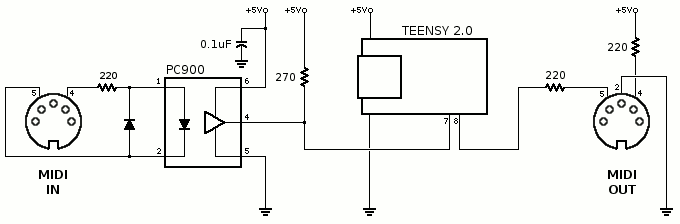

I've got an Alesis Performance Pad plugged into a MIDI IN connector which is routed to pin 7 on my Teensy 3.1 according to (the left side of) this schematic.
The quality of my craftsmanship is certainly in question but I want to make sure I'm testing with code that should definitely be working before I go pulling things apart again. Having the drum pad plugged in an beating on it should be enough to get MIDI.read() to register TRUE shouldn't it?

I ran a test on the three serial options for midi read this evening, and yes, serial3.read() gives different output to the serial monitor than Serial1 and serial2 read prints to serial monitor. However, this may be because I did not put proper hardware in, no resistors etc, not as should be as described at https://www.pjrc.com/teensy/td_libs_MIDI_sch.gif
With the addition of: Teensy 3.0: Use two 47 ohm resistors on MIDI OUT, with the pin 4 resistor to +3.3 volts. For MIDI IN, connect the 270 ohm resistor to +3.3 volts.

Final answer...YES, Teensy 3.x (and presumably LC) can receive MIDI on all three serial ports. I moved the MIDI input to pin 0 and, when that wasn't working, I knew I had some wires crossed on my MIDI circuit. I sorted that out and got it working on Serial1 but I figured it would be more noteworthy if I actually got it working on Serial3. So I move it BACK and after changing line #44 in midi.h to this:
#define USE_SERIAL_PORT         Serial3
This test code works fine.

MIDI in works fine but the signal seems to be jumping to adjacent pins. Down on pin 7 it was between the clock and latch pins of my serial display causing all kinds of weird things to happen. I figured I'd just fiddled with pin 7 one too many times so I moved MIDI in back up to pin 0. Pin 1 is a switch using INPUT_PULLUP and Bounce. Now every time I send a note to pin 0, the input on pin 1 also gets triggered.
UPDATE: I just answered my own question. It was a simple oversight. If you want to use a TX pin for something other than MIDI output, you need to tell MIDI.h
#define COMPILE_MIDI_IN         1           // Set this setting to 1 to use the MIDI input.
#define COMPILE_MIDI_OUT        0           // Set this setting to 1 to use the MIDI output.
#define COMPILE_MIDI_THRU       0           // Set this setting to 1 to use the MIDI Soft Thru feature
