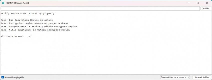

In the meantime, it turned out that something with my existing PlatformIO installation collided: PlatformIO also opens an instance of TeensyLoader for programming, and for some reason the version of that TeensyLoader was 1.55 instead of 1.56 which i did not notice before.
In parallel to PlatformIO, i also had Teensyduino 1.56 open, but which used the same instance of TeensyLoader 1.55 that was previously opened by platformIO. This is what produced the error message from my post above.
--> Closing PlatformIO, closing TeensyLoader 1.55 and letting Teensyduino open TeensyLoader 1.56 solved the problem.
The good news is that i did not "waste" any Teensy boards with miswritten fuses, i could upload my key to all testboards and can run my encrypted firmware now.

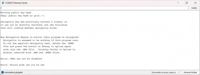

Hello,
Can you please help us out how what we are doing wrong?
Please find attached the picture.
Also we are not sure if we have a teensy 4.1 with lock or not? How can we check that?
Ted
"Error: Secure mode can not be set" means you have standard Teensy.
