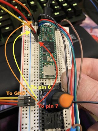

Hello all!
I am trying to use one of these "Anmbest" brand rotary encoders: https://www.amazon.com/gp/product/B07MW7D4FD/ref=ppx_yo_dt_b_search_asin_title?ie=UTF8&psc=1
...with the tutorial from: https://www.instructables.com/Improved-Arduino-Rotary-Encoder-Reading/
I'm using a Teensy 4.1 as the microcontroller.
No matter what I try, I cannot read ANYTHING from the encoder. I've tried every possible combination of pins on the 3-pin side of the unit (on the theory that maybe I'm misreading their diagram and that maybe any one of them could be the intended GND). I've tried having the interrupts watch for FALLING as well as RISING. No dice. It won't read anything. The interrupts never fire, no matter how much I turn the knob or how I wire it. (I've tried several different knobs. Same problem.)
Code is below.
Any help would be very much appreciated!
Best,
Leah
The first thing to do is check the pinout of the encoder by buzzing it out with a multimeter or
continuity tester. You need to start by being certain which pin is which and connect to A, B, gnd.
Randomly guessing and hoping is not the way to make progress.
Secondly you need to then check the encoder pins are connected to the Teensy pins again by buzzing them
out once wired in the breadboard.
Then power up and check (voltage setting, not resistance) that the encoder A and B are alternating
from pulled-up (3.3V) to grounded (0V) as the knob is turned slowly.
Only then does it make sense to start worrying about the software side of things, get the hardware in
a known good state first.
I FIGURED IT OUT! :)
The problem was in these lines:
attachInterrupt(0,PinA,RISING); // set an interrupt on PinA, looking for a rising edge signal and executing the "PinA" Interrupt Service Routine (below)
attachInterrupt(1,PinB,RISING); // set an interrupt on PinB, looking for a rising edge signal and executing the "PinB" Interrupt Service Routine (below)
Per https://www.arduino.cc/reference/en/language/functions/external-interrupts/attachinterrupt/, I learned that the recommended value for parameter #1 to attachInterrupt() is to pass the output digitalPinToInterrupt(PIN_NUMBER).
I thus changed my code to:
attachInterrupt(digitalPinToInterrupt(pinA),PinA,CHANGE); // set an interrupt on PinA, looking for a rising edge signal and executing the "PinA" Interrupt Service Routine (below)
attachInterrupt(digitalPinToInterrupt(pinA),PinB,CHANGE); // set an interrupt on PinB, looking for a rising edge signal and executing the "PinB" Interrupt Service Routine (below)
Voila!
Good the signal pins were found.
The digitalPinToInterrupt() isn't needed on Teensy, but yes, it needs to see every CHANGE not just RISING.
Better probably would be using the encoder library as linked in p#2: teensy/td_libs_Encoder.html
It will have tested library code to best handle the encoder decoding on interrupts in the background.
