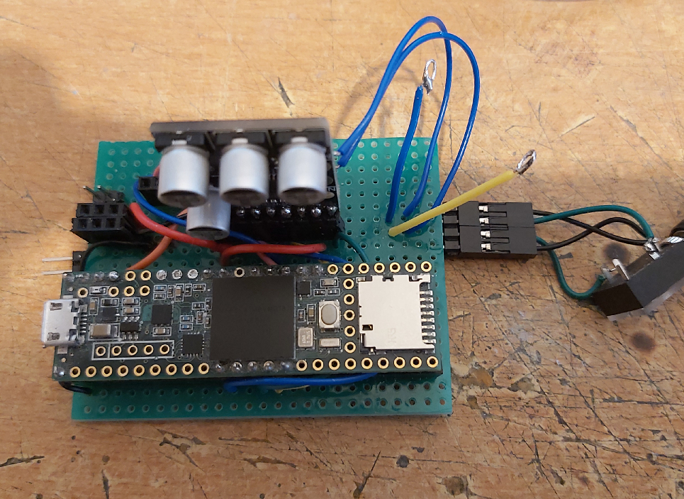

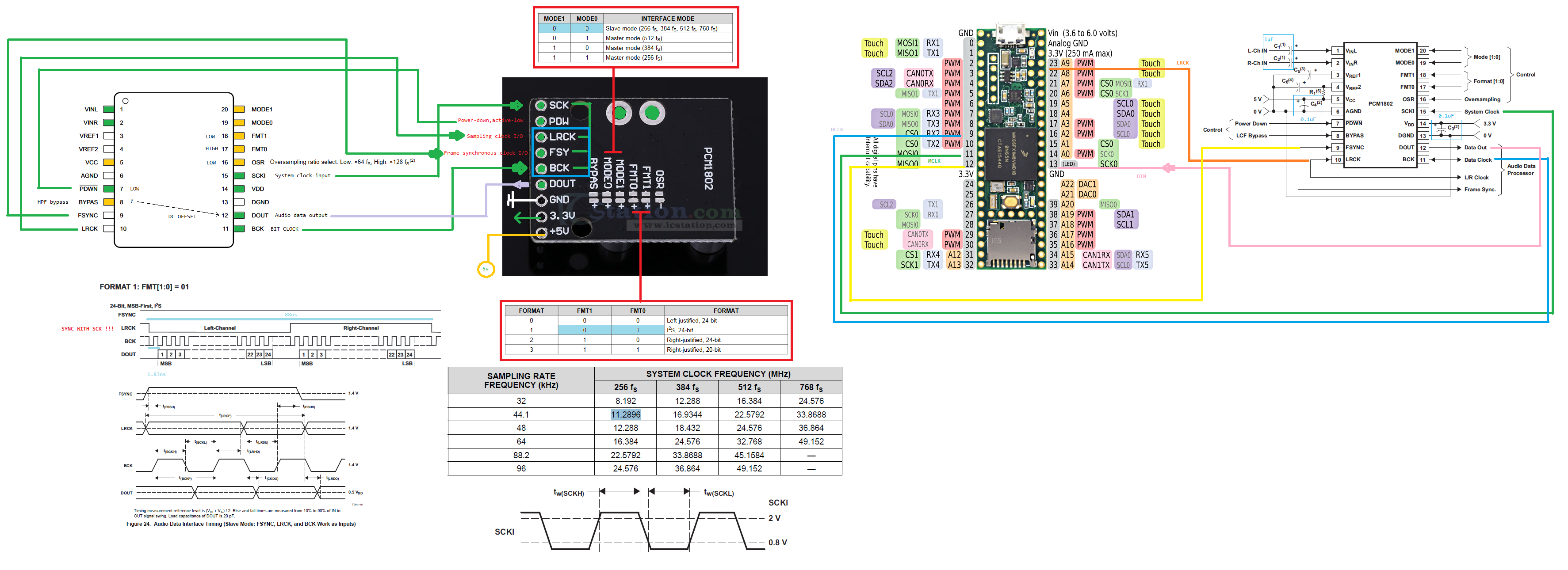

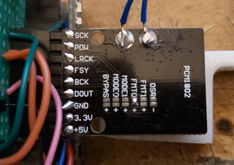

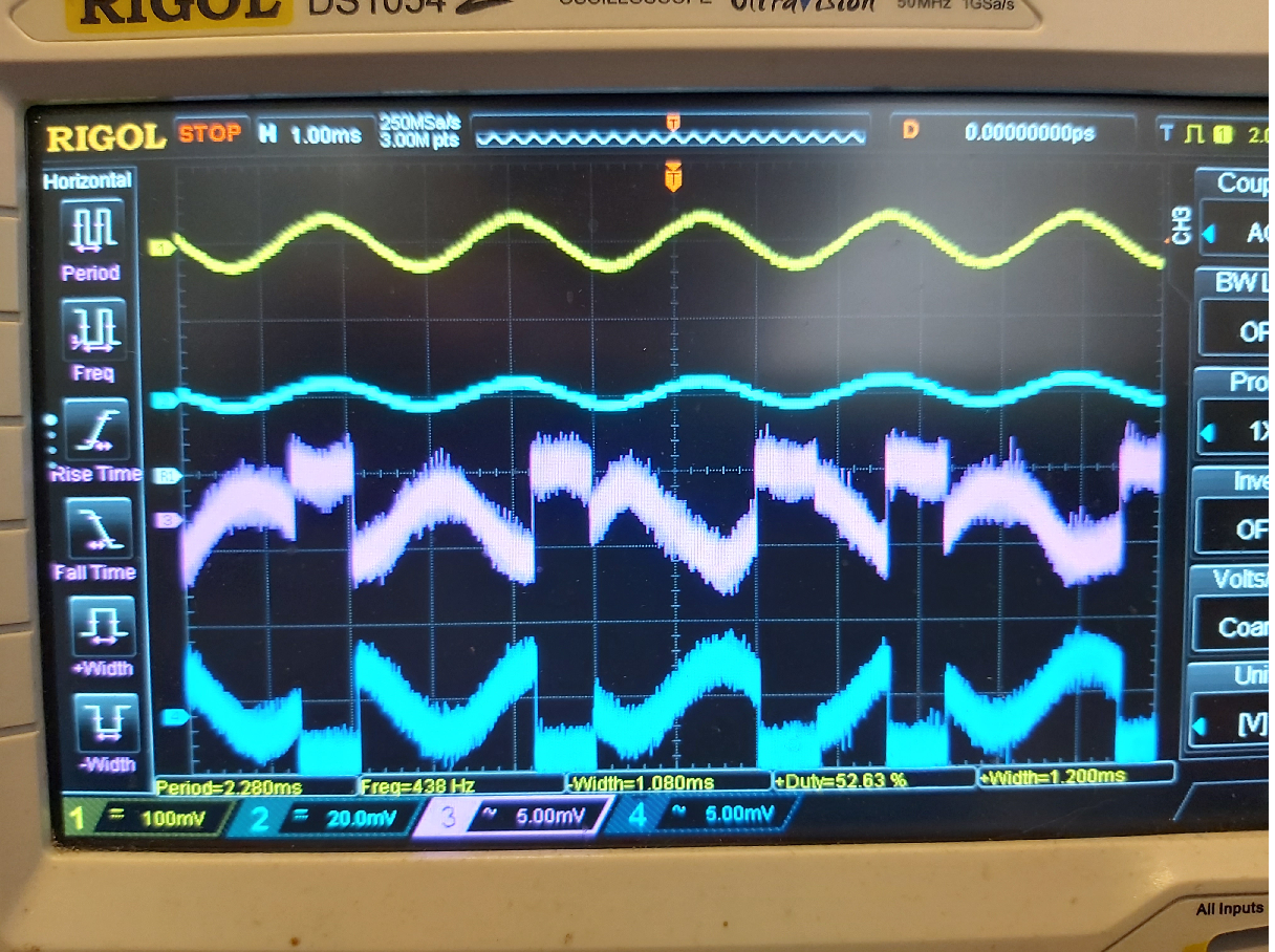

I try to use a PCM1802 and I noticed that the output was sliced, the data coming in are sliced too (parts are missing, DOUT is outputing nothing here and there)

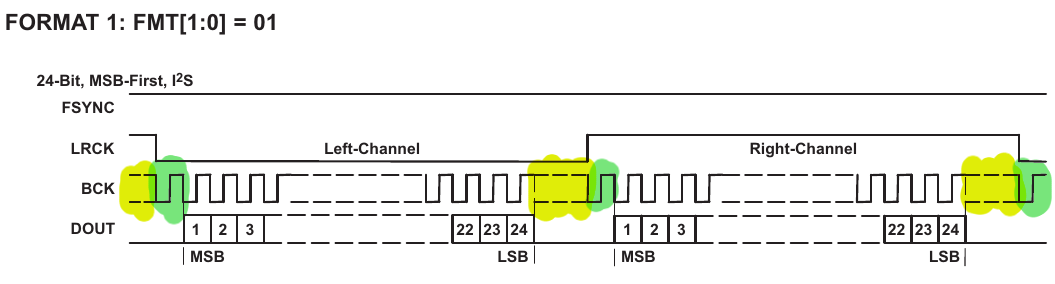

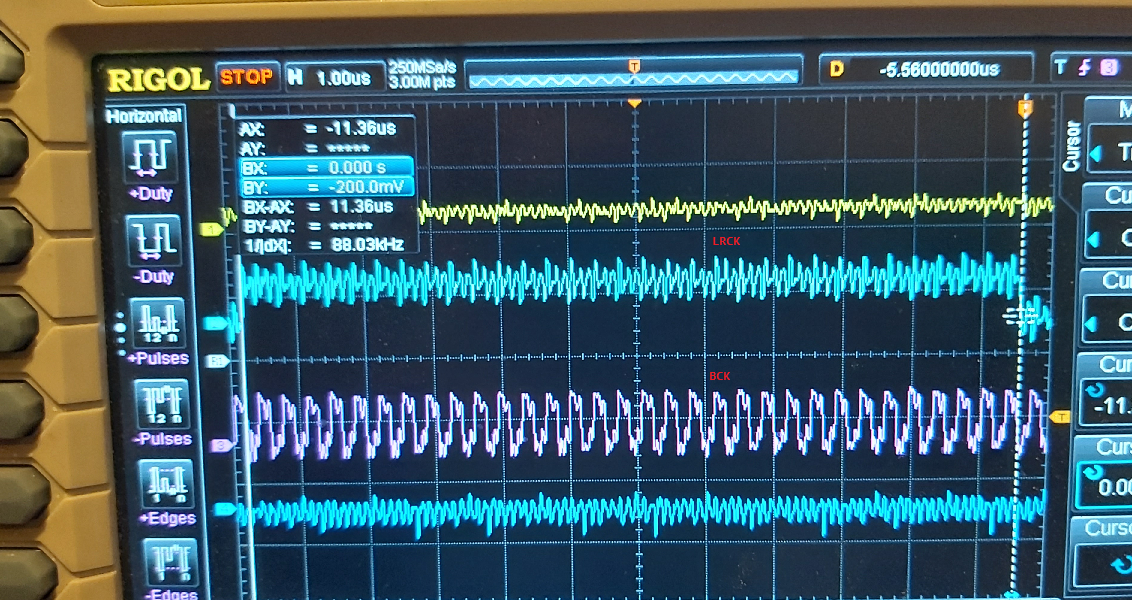

so I checked the BCK signal and I noticed that the teensy (3.6) outputs 32 clocks of each L/R channel (LRCK)
while the datasheet says it has to be 48 in total, 24 BCK edges per channel
is there a way to change this in the audio code library ?
here is my test code
thanks in advance
