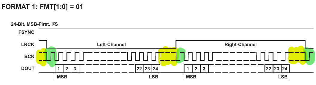

Since you have a scope, I'd recommend using it to watch LRCLK, BCLK and DATA. Set your scope to trigger on LRCLK.
My guess is you'll see the bits immediately after LRCLK flickering wildly. If there isn't a consistent logic low for 1 BCLK cycle after LRCLK changes, that's a sure sign the PCM1802 is transmitting left justified data rather than I2S.
It should look like that waveform above, with always logic low for 7 cycles before LRCLK changes (the yellow part) and 1 cycle after LRCLK changes (the green part).

Use your scope to view LRCLK, BCLK and DATA, as I tried to explain in msg #26. If you need more help to do that, just ask.
I have a hunch the waveforms are going to turn out to be left justified format, because the wrong analog waveforms on msg #15 look pretty much like too much non-clipping gain applied, causing integer overflow.
Look, this isn't the first time. Over and over this same conversation has come up on this forum, where someone misreads the datasheet and believes their chip expects exactly 24 BCLK clocks per phase of LRCLK. It's a common misunderstanding, because these parts of the diagrams (highlighted yellow and green) aren't always clearly explained.
And, it seems like every manufacturer that makes an I2S device puts that same picture in their datasheet, many times with no further explanation. It would be so much easier if they just put in tabular form all possible combinations of:
  • Sample Rate
  • Number of (significant) bits per sample
  • MCLK Freq
  • BCLK Freq
Be that as it may, it doesn't excuse a bad attitude and hostility directed at those providing correct information.

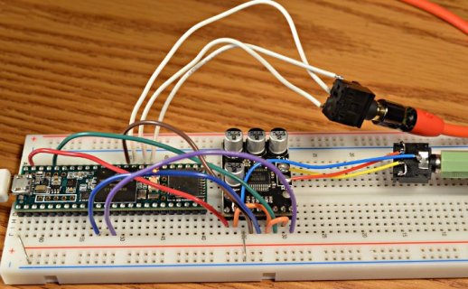

Finally, almost 11 months later, I'm finally looking into this problem. I ordered this PCM1802 board back in February, but it took months to arrive. When it did get here, we were in the 1st lockdown of the pandemic, and struggling to get Teensy 4.1 released. So it sat on my workbench until now....

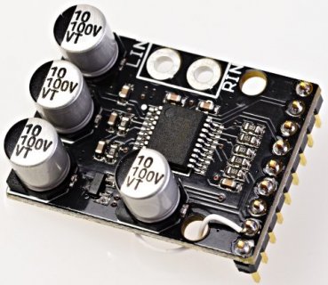

I'm pretty sure the problem all along has been the PCM1802 running in left justified format, but Teensy needs it to use I2S format. The FMT0 pin is supposed to be changed to logic high to put the PCM1802 chip into I2S mode.
Phil's photo on msg #24 does indeed have the FMT0 pads soldered together. So it should work, right?
Turns out the "+" side of those 5 jumper pads isn't connected to 3.3V power, or anything really. It's obviously a PCB design error!
It took me a while to get this macro photo with just the right light so you can see the PCB traces. Clearly the trace connects those five "+" terminals together, but then it doesn't actually route anywhere else. At first I couldn't believe this. But I tested with my ohm meter between those 5 pads and many other places on the PCB. There is absolutely no connection.
So even though Phil correctly configured FMT0 in the msg #24 photo, the chip was still running in left justified mode because those pads don't actually do anything!

To get it correctly configured, I had to solder a wire from the 3.3V pin to the FMT0 pads.

Oh man, ordered my PCM1802 a few weeks ago and it should arrive in the next couple days. You've probably saved me days of trouble shooting with this. thanks Paul.
