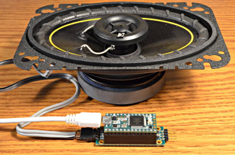

Thanks Michael this is great. I see you are using the flash memory chip. Can I do the same using the internal memory functions? As in AudioPlayMemory ?
Sure, I believe mixer is just takes 1-4 inputs of any sort and produces one output. And you can cascade them (feed 4 mixers into another mixer that handle 16 input streams).
This code will alter the volume of a sound played from the SPI Flash chip while it is still playing:

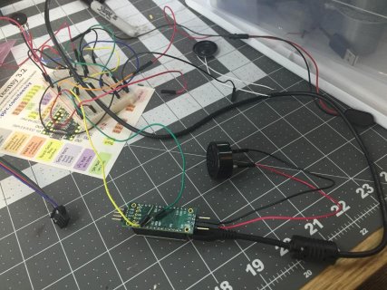

Hi guys and thanks for the input. OK, I've got some code here. It uses the Newping library as I'm using an HC-Sr04 ultrasonic. The sensor works fine but the audio sounds really jumpy. Do I need to use interrupts for the measuerment? What am I doing wrong?

     unsigned int uS = sonar.ping(); // Send ping, get ping time in microseconds (uS).
      vol=(uS / US_ROUNDTRIP_CM) *0.005;
    //  Serial.println(vol);  check range  --not above 1.00
     sgtl5000_1.volume(vol);
  playFile("night.WAV");  // filenames are always uppercase 8.3 format
Hi Paul. Ive not looked into interrupts as I've got some better results using ping_median to average out the sensor data. Looks like the noise was caused by the data jumping.. Seems a lot smoother now. :)

What else am I missing? I've got a simple 8-ohm speaker hooked up but am getting nothing.
Anyone have any ideas of what I should be looking for? I'm totally stumped.
What else am I missing? .... I'm totally stumped.
I'm totally stumped too, because I can't see what you've done. We have the "forum rule" (in red, at the top of every page) so your message can have enough info that we can help you. It's probably something simple, but nobody can see the problem if you hide the complete info.
Please, post the exact code you're running, and a photo of how you've connected things.
I apologize, I quoted the code above because I copiedand pasted it into my editor (changed the audio file name) and wasn't working. I'll repost my code when I can get back to the machine.
Here's the code I'm running and a photo of the setup.
Looks like it ought to work, if the file really is on the flash chip.
Can you run File > Examples > SerialFlash > ListFiles and post the results you see in the serial monitor? Don't forget to edit the pin numbers to match your hardware.
Ummm, your pictures don't show that the DAC pin is connected between the Teensy and the Prop Shield. This pin is on the back of the Teensy, next to pin 13. The DAC pin is connected to the amplifier, and is how the prop shield makes sounds.

With Teensy 3.2, the Teensy Audio Library can be used to create sounds. Nearly all the audio library examples are designed for the Audio Shield. To adapt them for the Prop Shield, replace "i2s1" with "dac1" in the Design Tool, or AudioOutputI2S with AudioOutputAnalog in the Arduino code. Then delete the SGTL5000 object and any code which uses it.
For the samples in the Audio Tutorial - they could all (except for the mic input) be written and done with the Prop Shield once the sound files are stored on the 8MB flash?
Note, the prop shield is mono, while the audio shield is stereo. So if you have stereo sounds, you need to use a mixer to blend both channels at 50%.
Yup, that was one problem for sure. I should have caught that but I think I looked at the image at http://www.pjrc.com/store/prop_shield.html under Audio Amplifier and just subconsciously didn't add those headers since they weren't in that photo. I should have thought through it.
So, I;ve added them now, and it makes a clicking noise when the sound should be playing, but the actual sound is coming through correctly. Anything else obvious that I'm missing?
Thank you guys!!
