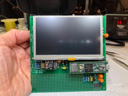

Just FYI, I have an open-source design for a Teensy 3.6 driven board with 24-bit differential ADC that delivers nearly the full ENOB at 144 s/s and early next year will release one with touchscreen, GPU, WiFi and clean analog supply. All are low-cost... the point.
Thanks,
Greg
