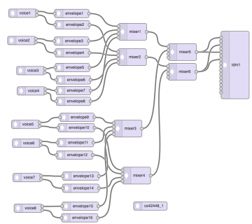

I've been testing stereo, but somewhere between my sample loader, polyphonic mechanism, im getting a few tiny audible pops on the lower notes...
Moo, just got my board today. Getting everything up and running tomorrow. Looking forward to testing out your library!
I've managed to fix a few tiny issues and it sounds great in stereo now. I tested on teensy 4.1 with 8 stereo voices and it sounds good.
I merged the stereo branch and release TeensyVariablePlayback 1.0.7, it should be available through the Arduino library manager soon.
