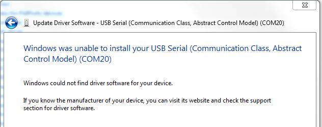

Paul - thanks for the reply. I tried rerunning Teensyduino, re-plugging Teensy, I went back a several restore points (this is Win7 Pro64) and finally got Teensy to be recognized, and I am able to program it and use the serial debug console, but Device Manager reports it is not Teensy:
TeensyFoundAsWrongDevice_2014-05-06 11-29-00.png - so I tried updating the driver letting Windows find the update, but that failed:

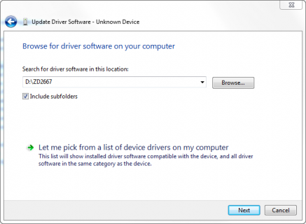

OK, after a hiatus of a month I am back in this tar pit. Re-read Paul's last advice. Selected "unknown device" in device manager, and right-clicked, then "Update Driver Software", but selected "Let me pick from a list..."

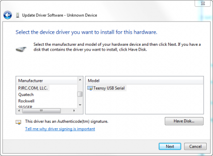

Then I selected Manufacturer: PJRC.COM. LLC. and Model: Teensy USB Serial, and continue through.

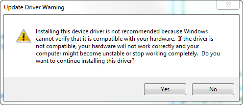

and this dire warning
Then Teensy3 showed up as COM10.
