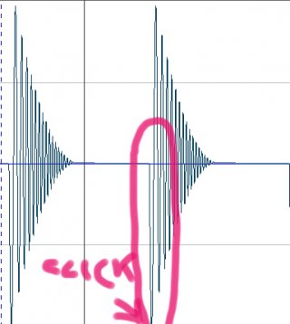

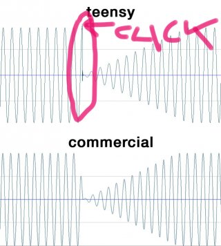

Clicks appear to be gone now that I check on every sample for overflow. I'm sure Paul can code this more efficiently than what I'm doing here, but the principle works fine. Below is the cpp code of the modified envelope object. If you want to use it, you will also need to create an "effect_reenvelope.h" file that is just a copy of the original .h file with the class name changed to AudioEffectReEnvelope.
