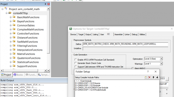

With that said with come poking around I did find that in version 5.5.0 they provided a uVision project file that you can you to compile the binaries for the library:
1. Downlowad the MDK µVision® IDE from ARM-Keil website
https://www2.keil.com/mdk5/uvision/ (Overview)
https://www.keil.com/download/product/ (download MDK-ARM - you will have to register)
2. Download Arm GNU Toolchain (my case I picked 11.3.1) to be inline with what we are currently using.
https://developer.arm.com/downloads/-/arm-gnu-toolchain-downloads
3. Then I downloaded the latest versions of CMSIS5 and CMSIS-DSP and put them on my D-drive (made my life easier.
4. Copied the project file for gcc and made some major edits to cover all the new library functions and edited the file paths for each board I wanted to compile for.
a. In [ project->manage -> project Items ] I deleted all the groups and recreated them using all the new groups and files from the latest CMSIS-DSP source folder.
5. Then I selected the processor I wanted to compile for and did a left click and selected: Options for target board. In the CC Tab i edited the paths for files:
Then I did the Build for the target and got my compiled binary for the library. However the library files are now 9Meg versus the 2-3 meg they were before so not sure if all the compile options are correct but they are the default ones that come with the project file.
The last step was to update the arm_structs.h and arm_constants.h files in the cores.
I will post the files in a repository if anybody wants to do some further testing - need to the end of the day.

The latest version of CMSIS DSP is no longer easy to port to Teensy with out going through and generating your arm_math.a files.
Paul has a script for that. I had it, but deleted it. Maybe you can find it on github.
I guess he must have run it for the new compiler(?) I don't think that the lib is still the sameas for the old compiler. (One could compare the files, but I don't bother).
No the library has completely changed from the version that is currently in the Teensy. If compared what was say in version 5.3 versus now you will see that there are an close to 50% more files than there was before.
Even if I could find the script it was probably based on the older versions and incomplete. I just posted everything to Github including the library's plus the updated core files. Pretty much just a cut and paste operation now.
https://github.com/mjs513/Teensy-DSP-1.12-Updates
Basically just copy and paste files in the TeensyX Files to the associated cores where ever you placed you TD install's. For me that would be
..\arduino-1.8.19-1131\hardware\teensy\avr\cores\teensy3 or teensy4 directories
Then copy the lib files in the Precompiled Binaries to:
..\arduino-1.8.19-1131\hardware\tools\arm\arm-none-eabi\lib
Then you are good to go. No need to edit the files.

wondering if the following is correct for the Teensy4's - would like to reduce that 9mb file size at some point
Misc controls
-fno-strict-aliasing -ffunction-sections -fdata-sections -mfpu=fpv5-sp-d16 -mfloat-abi=hard -ffp-contract=off
Compiler Control String
-c -mcpu=cortex-m7 -mthumb -gdwarf-2 -MD -Wall -O3 -I ..\..\..\Core\Include -I D:\CMSIS-DSP-1.12.0\Source -I D:\CMSIS-DSP-1.12.0\Include -I D:\CMSIS_5-5.9.0\CMSIS\Core\Include -I D:\CMSIS-DSP-1.12.0\PrivateInclude -fno-strict-aliasing -ffunction-sections -fdata-sections -mfpu=fpv5-sp-d16 -mfloat-abi=hard -ffp-contract=off -I"D:\Program Files (x86)\Arm GNU Toolchain arm-none-eabi\11.3 rel1\arm-none-eabi\include" -I"D:\Program Files (x86)\Arm GNU Toolchain arm-none-eabi\11.3 rel1\lib\gcc\arm-none-eabi\11.3.1\include" -I"D:\Program Files (x86)\Arm GNU Toolchain arm-none-eabi\11.3 rel1\arm-none-eabi\include\c++\11.3.1" -I"D:\Program Files (x86)\Arm GNU Toolchain arm-none-eabi\11.3 rel1\arm-none-eabi\include\c++\11.3.1\arm-none-eabi" -D__UVISION_VERSION="537" -D__GCC -D__GCC_VERSION="1131" -DARMCM7_SP -DARM_MATH_MATRIX_CHECK -DARM_MATH_ROUNDING -DARM_MATH_LOOPUNROLL -o *.o
Ok fixed issue I was having with the 9mb prebinary compile sizes. Reduced it to <4mb. Updated Github with the changes.

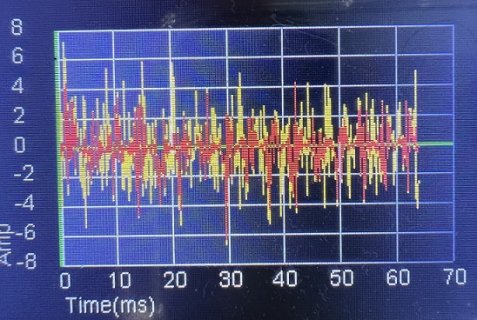

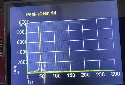

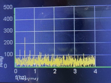

Out of this tendency I have for torture I ran an example I found on line using a 697hz tone that was generated from audacity: https://m0agx.eu/2018/05/23/practical-fft-on-microcontrollers-using-cmsis-dsp/.
Porting the example to for the T4 - get the same bin for the max frequency as they got, bin 44. As for the graph - since I am a glutton for punishment I used @KrisKasprzak ILI9341_controls library to generate the following graph:
If you are interested here is the file:

    arm_rfft_q15(&fft_instance, (q15_t*)WAVES[i].data, output);
    arm_abs_q15(output, output, FFT_SIZE);
    uint32_t c_stop = micros();
    //printf("%s %ld \n", WAVES[i].desc, c_stop-c_start);
    for (uint32_t j = 0; j < FFT_SIZE; j++){
      //printf("%d, %d\n ", j, output[j]);
        MyGraph.setX(j);
        MyGraph.plot(fftID, output[j]);
    printf("\n");
    arm_max_q15(output, FFT_SIZE, &pResult, &index);
    //printf("Max Val: %d, Bin: %d\n", pResult, index);
    Display.setCursor(50,20);
    Display.setTextColor(C_YELLOW);
    Display.print("Peak at Bin "); Display.print(index);
  while(!Serial){};
  // fire up the display
  Display.begin();
  Display.setRotation(1);
  Display.fillScreen(C_BLACK);
  // initialize the graph object
  MyGraph.init("", "bin", "mag", TEXTCOLOR, GRIDCOLOR, AXISCOLOR, BACKCOLOR, PLOTCOLOR, FONT_TITLE, FONT_DATA);
  fftID = MyGraph.add("mag", SINCOLOR);
  MyGraph.drawGraph();  //draws empty graph
  fft_test();

First chart shows the raw signal (yellow) and windowed signal (red)
With spectrum:
for which I get:
Index: 128, freq: 500.000000,  MaxValue: 247.432098

Here's an example of radar data captured and processed with CMSIS FFT's and converted to dB. I captured and processed this data on an M4 device this morning. This is the response of a doppler radar to a tuning fork. I made this doppler radar from an X band door opener module and an analog front end that I designed. Sample rate = 60 KHz, 1K floating point FFT's. Continuously running, one FFT per 17.05ms. Automatic detection and velocity estimation. ADC data collection using DMA and ping pong buffers. Process one buffer while other was filling up. All the signal processing was done in 17.05ms or less. Detected display was done asynchronously.
The peak detected line is about 60 dB greater than the median noise floor. ( 1,000,000 times more power than the noise ) I'm afraid one wouldn't know anything about the rest of the waveform had it been done in a linear vertical scale. Vertical scale is 10 dB per division. Basically, this is why hard core radar guys always use log scaled data.
Wish I could say I did this on a Teensy, but at the time I built this three years ago, I hadn't an inkling of Teensy's. I used the internal "12 bit" converter on the processor. Detects small objects, like an airgun pellet in flight at up to 1250 feet per second. Just an example of what can be done with the CMSIS DSP library.

You might what to check this project out - along the same lines but using a Teensy: https://forum.pjrc.com/threads/4562...mance-of-cheap-doppler-radar?highlight=x-band
Started playing but then dropped it.
That's where I got the initial idea. But the analog circuitry is not up to the task to detect very small objects at 1250 FPS. That corresponds to roughly 30 KHz. JBeale's circuit is good for a couple of KHz at most, if I recall correctly. I designed an active 7 pole analog Chebychev filter with at least 80 dB rejection at frequencies greater than fs/2. This greatly reduces noise from fs/2 to fs from folding over into the region 0 to fs/2. This is essential to reduce the noise in the system, which increases sensitivity.
Mr. Beale's design was a simple couple of poles filter and suffers from significant noise fold over. I have great admiration for his initial work. His work inspired me to try to roll my own, using the same radar module. I added in automatic target detection and a parabolic peak estimator for sub FFT bin speed determination. Mr. Beale's circuit was a fine demonstrator, but was designed for a less arduous task - showing pedestrians are seen by a radar. The target cross sections I am detecting are 100 times smaller and they are traveling 100 times faster. Totally different design goals and significantly greater demands on the design. It took me quite a while to get that filter to work right. High order analog filter design, at least for me, is tough. It's no wonder it has been supplanted by digital filtering. Automatic detection means I get a direct readout of the speed of the object at a far greater precision without me trying to interpret data.
Now in full disclosure, I had a long career in radar, so I'm familiar with the the signal processing techniques, detection theory, and parameter estimation. It was what I did for a living. For me, the hard part was the DMA and the ADC stuff, along with the ping pong buffer processing, not the radar aspects. All in all, it has been good fun. If I had any experience with Teensy's three years ago, I would have implemented it on one. But at the time, I had zero hands on experience. But in my favor :) I have seen the light, and used a Teensy 4.1 for my electronic lead screw for my lathe. Got that working this November. Really pleased with the ease of development and the level of support here on the PJRC forums.
